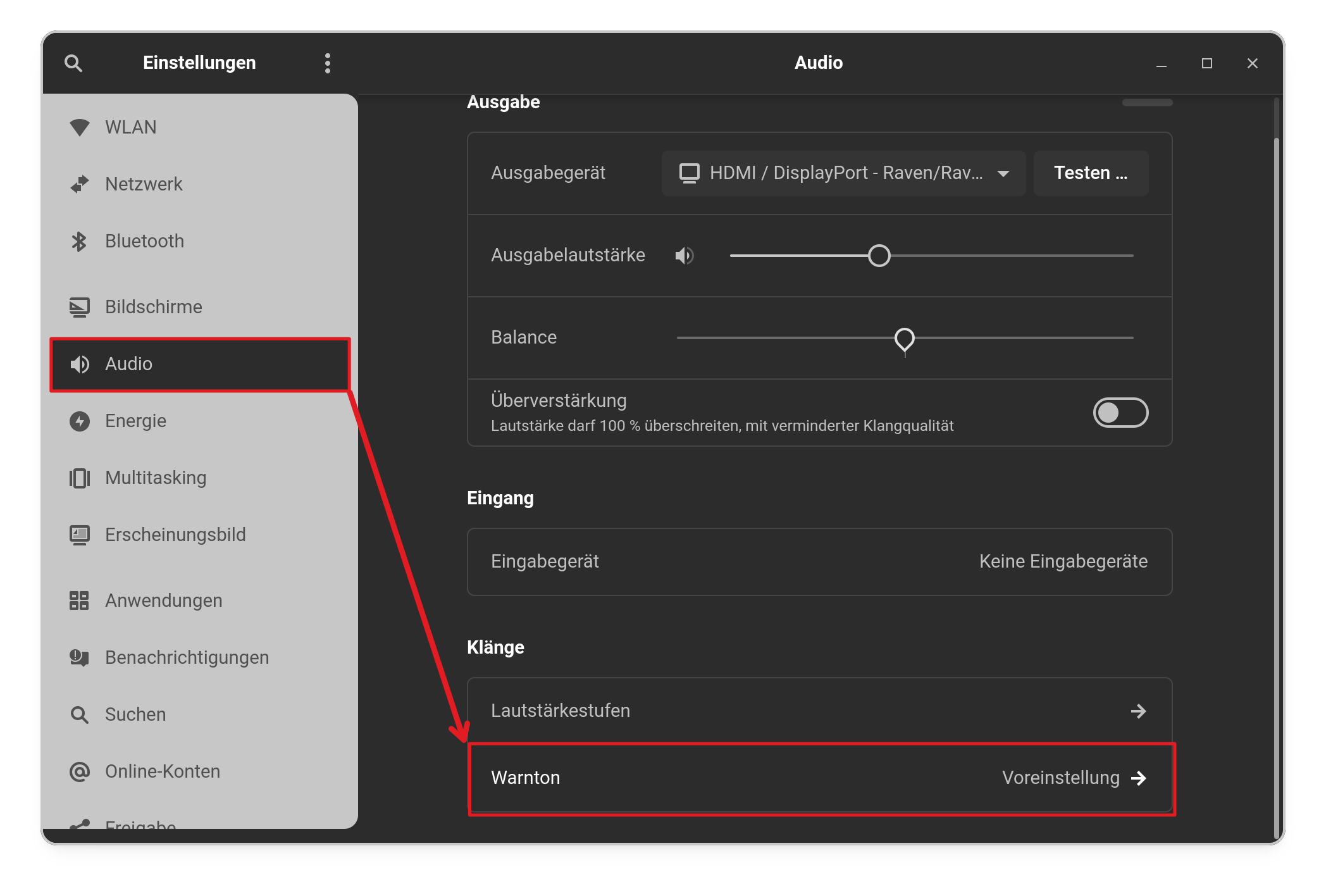

There is not much System Sound. Mostly only Warntones. Like @Forpli already wrote, You can set up a Tone in the Settings:
There is not much Choice but because You don't hear it often it shouldn't bother too much I guess.

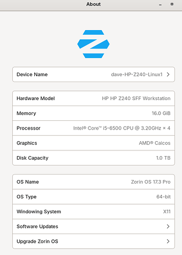

I'm on Zorin 17 and the only sound I hear is when I insert a flash drive.

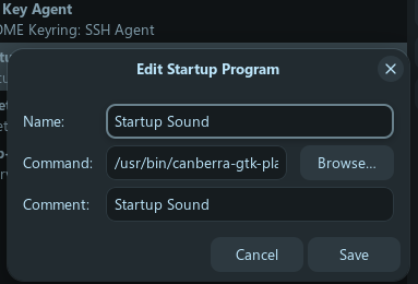

Open startup applications click add then make it look like this
the command line is
/usr/bin/canberra-gtk-play --id="desktop-login" --description="GNOME Login"
this will play to default startup sound will also play it when you log back in as well
make sure to hit save ....lol

When you boot Zorin in live mode you will hear a startup sound. This gets muted post install. It is present in Startup Applications, just enable it and you will then get the login sound.
That shouldn't be neccessary. The Startup Sound is there by default but disabled. It is enough to mark it as active:
