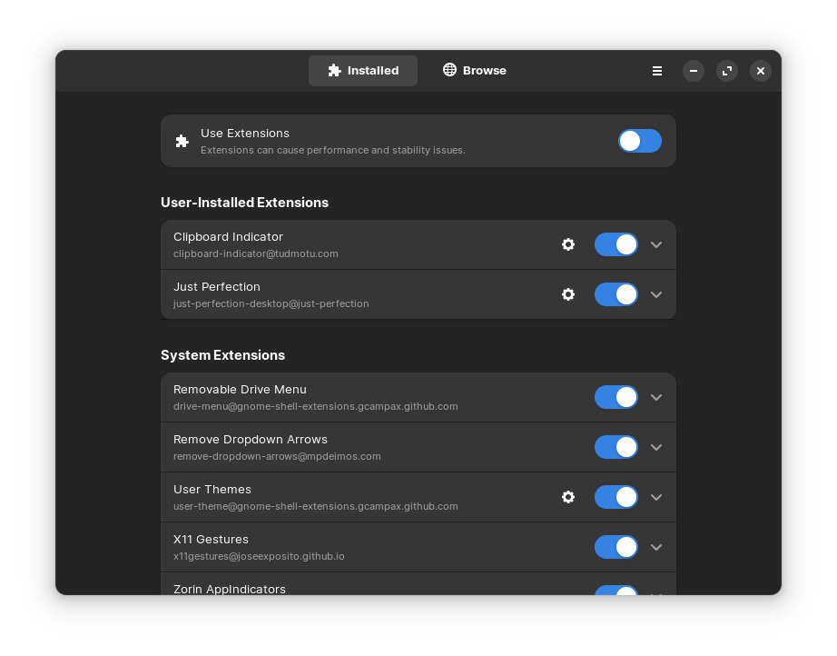

I think you've got a different extension manager. This is what it should look like:

Ah, apparently there is a different way to launch it that gives a different interface. I was running it from the item in Settings, but when I click Launch in the Software Store I see this, Zorin Menu is already enabled:
I get it now, the listing in Settings is the settings for this Extensions Manager app, but I had to run the actual app to see the list. I have not added any extensions.
