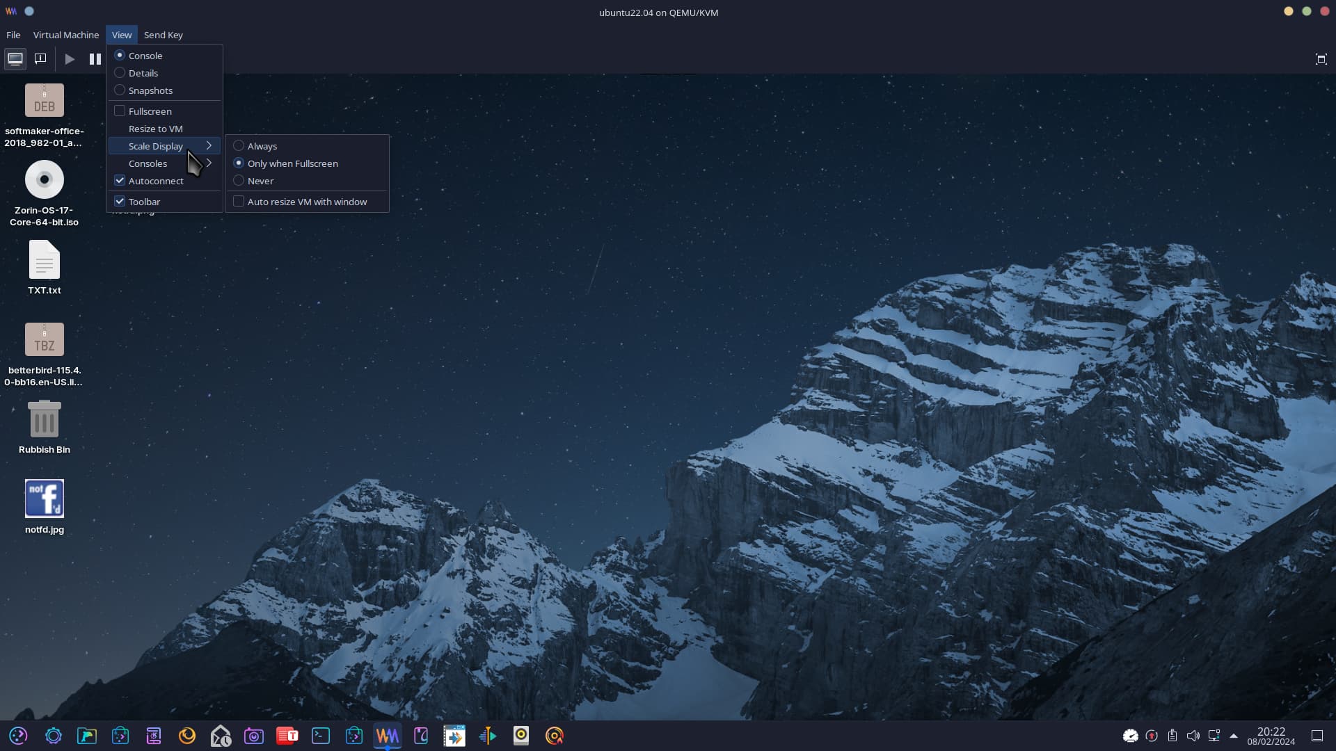

Is there a setting like in virt-manager, to view full screen? I only ask this as when I was working and had to use Windows 8.1 Pro as a VM, the panel would not show unless: VM display was;
a) set to be scaled always
b) set to full screen
I will post screenshot later.
