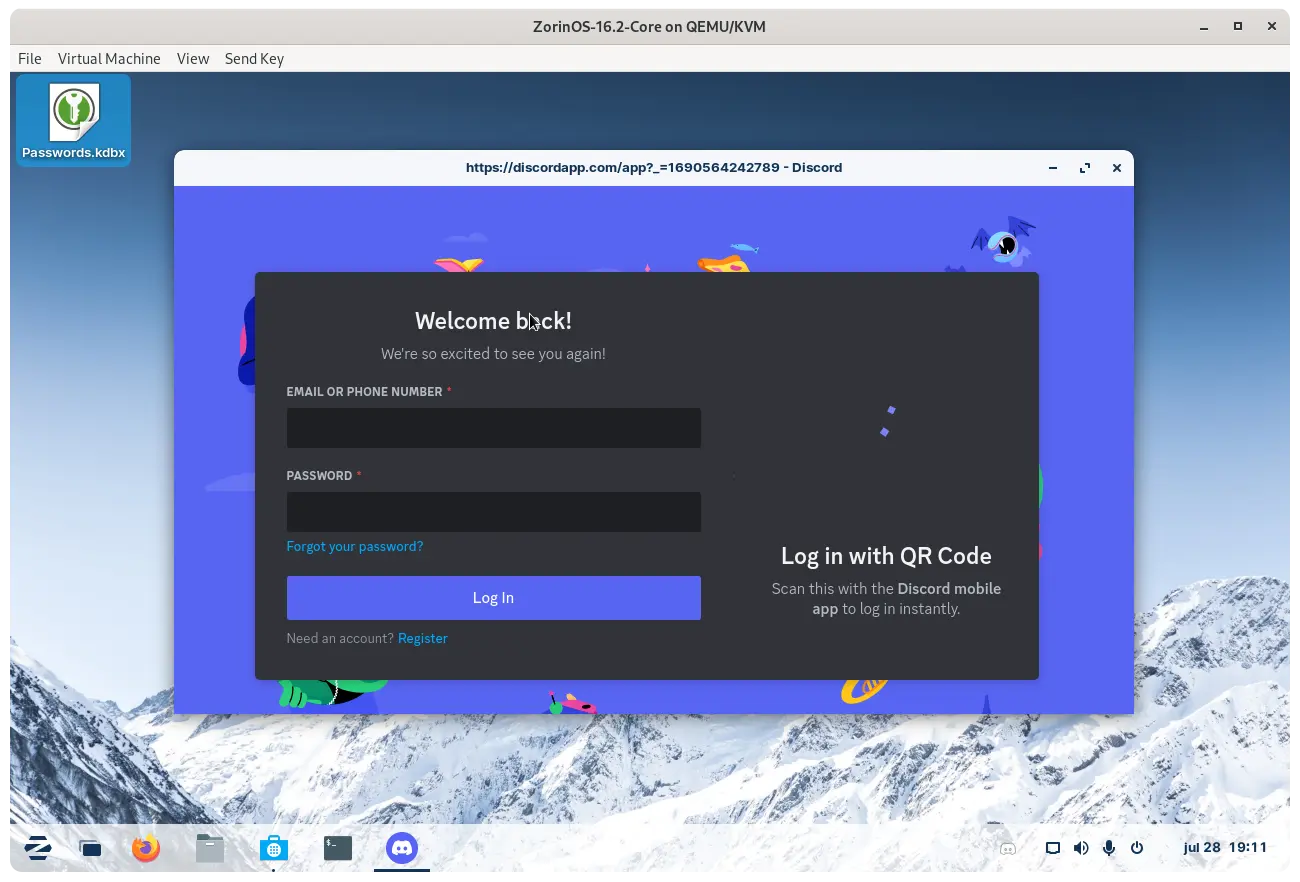

I just installed Discord from the Software Store as a flatpak, and then later from their website as a deb package, and both times I see the tray icon. Note that due to the light theme there's very little contrast and the icon is barely visible:

I did the same as you, I did a clean install of Zorin OS 16.3 Core in a virtual machine on my main PC, I have installed Discord in Software and when I open the program the Discord indicator shows without problems in the taskbar
