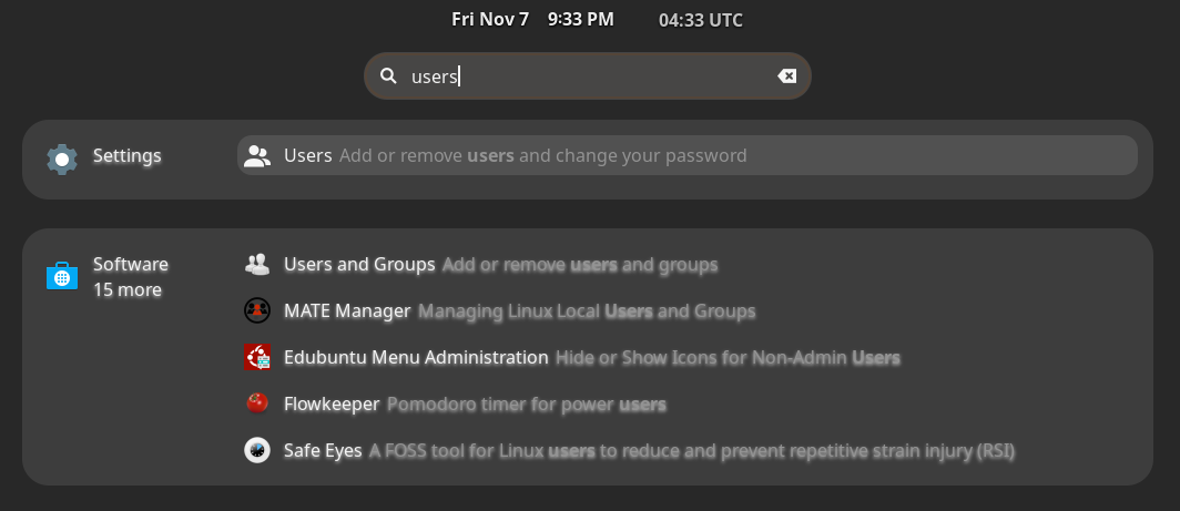

Using Zorin 18. I'm getting very blurry text in search results in the overview screen. See image. Same in Wayland and X11. Blur my shell is OFF. Otherwise, text in app windows is normal. Font is Liberation Sans 12 Regular. No font scaling used. I tried other fonts and they were all affected. Any ideas how to clear this up?
Do You have that on the App Grid, too? Press fast 2 Times the Super Key to get there.
I tested it with Zorin 18 boot stick and had the same issue with blurry not good readable text in app grid search.
Looking again at possible causes, I found the problem. It was partly caused by the gnome shell theme that I had chosen, which was not in the default set of themes. I should have thought of that (but didn't until now). Also, "blur my shell" extension has to be OFF.

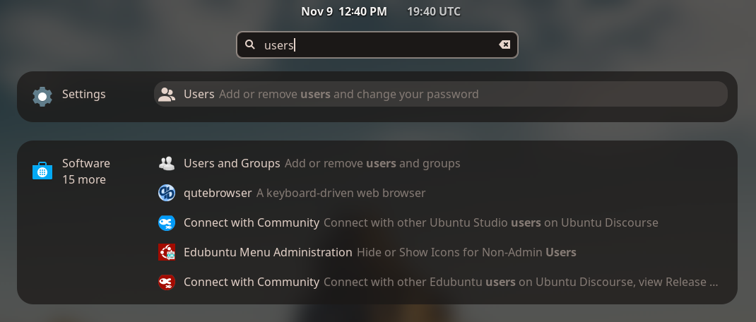

I found you can have 'Blur my shell' ON and have a blurred overview background with readable text in search results.
In 'Blur my shell' configuration settings, Overview tab, set 'Overview Components Style' to 'Do not Style'. That should fix the blurry text in search results.

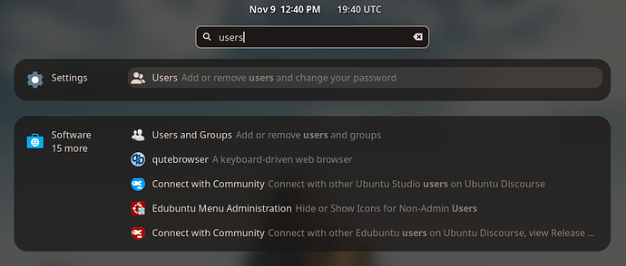

I also set the brightness down a bit:
Pipelines Tab > Default > Manage Effects > Native gaussian blur > Brightness. (I decreased from .60 to .35 - use your own judgment.)
