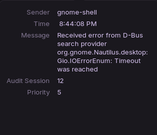

It works again as normal but eventually the same thing happens again. Is there anyway I can fix this permanently? I came across this log here.

Seems to be an issue with tracker3 as the moment I ran tracker3 reset --filesystem nautilus opened up. I'm hoping this is a permanent solution. Will report back when I feel certain or the issue happens again.
Even after a reboot and using my file manager on and off for over an hour it seems like the issue is gone. Just run tracker3 reset --filesystem and if anyone else having the same issue as I did it should fix it.
