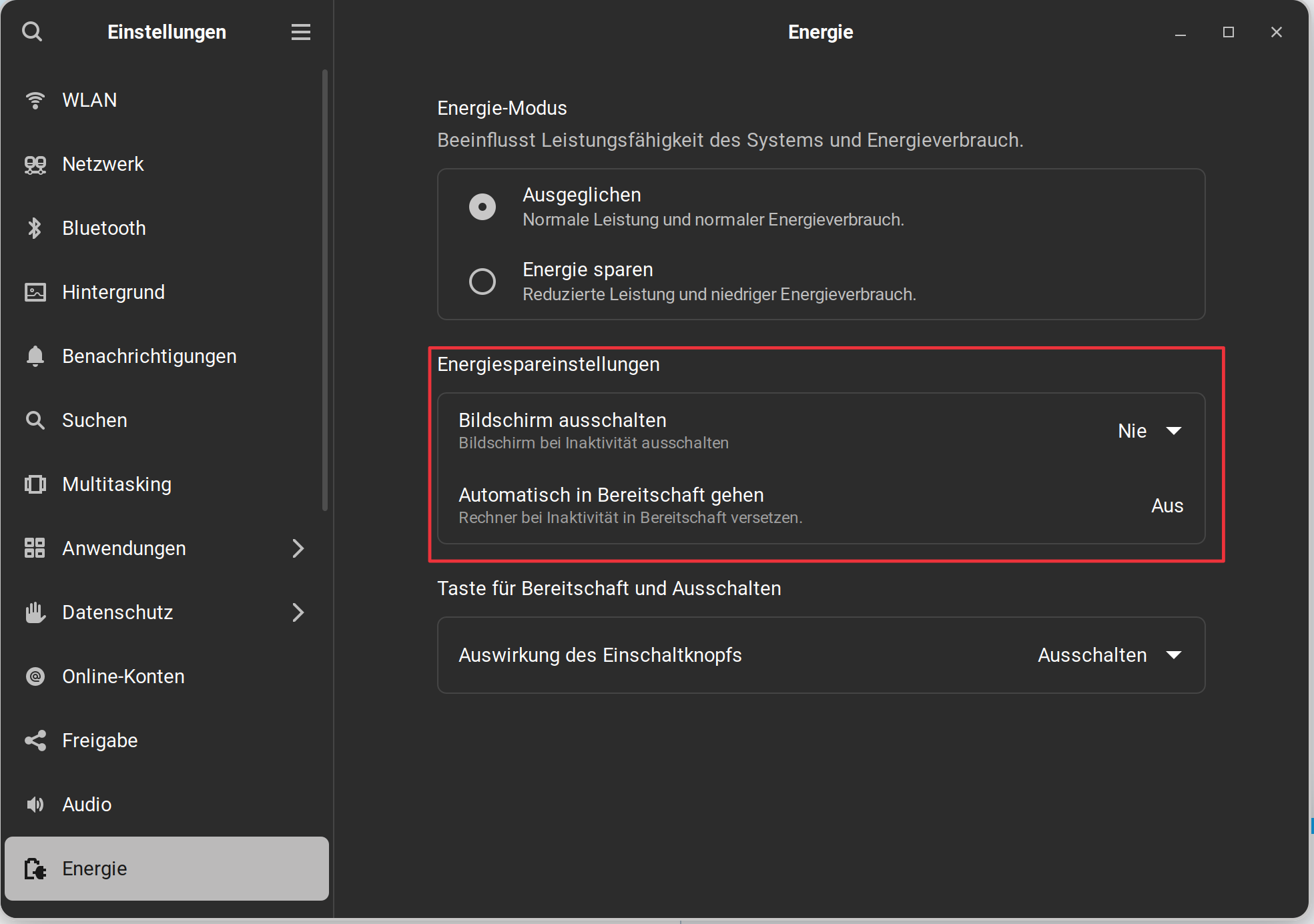

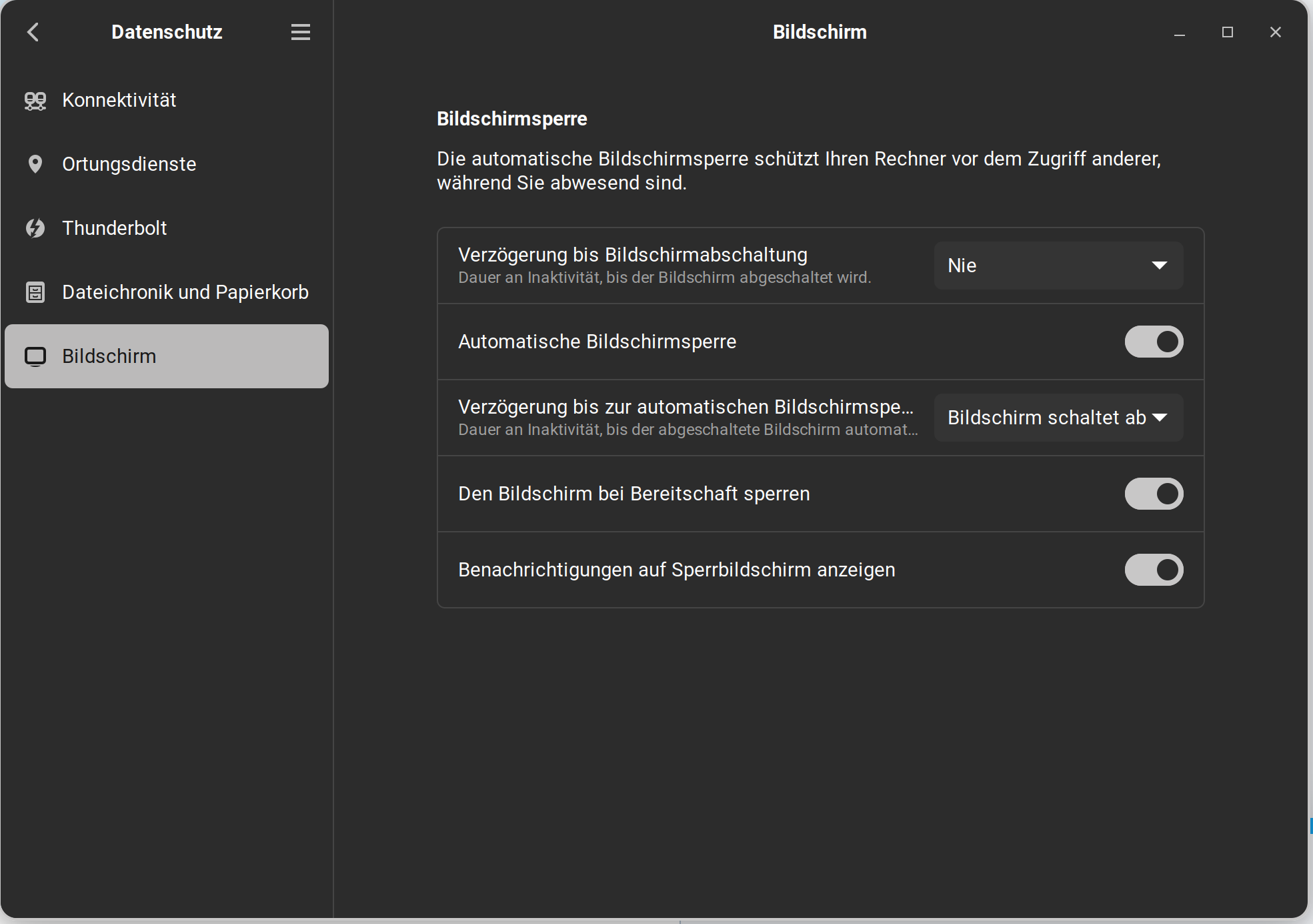

And how are the Settings in Settings>Power for the Display and in Settings>Privacy>Display set up? I mean these:
