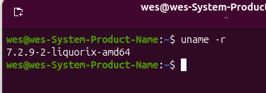

been running the Liquorix kernel for 9 months now and none of the problems most are having has effected me at all
current version
now mine is a computer made around 2019 tho
