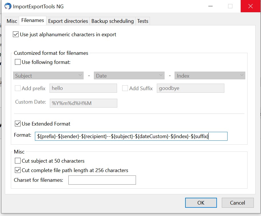

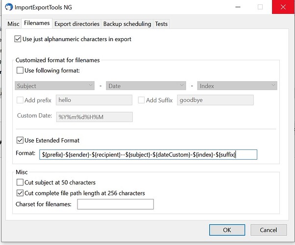

I'm not sure if perhaps the addon import-export-tool-ng for thunderbird could help you:
At options>filenames there you can set the format for email export.
Here is a picture from github:
Ya I found that in my searching yesterday. According to "Google AI" it says that installing ImportExportTool NG addon and configuring the customised save format should actually allow Thunderbird to save in that format by default even when using the normal Save As dialog, but upon trying it that is not at all the case. Thunderbird only saves with the configured format in the addon when actually using the addon which is kinda what I expected would be the case despite what the AI said. Unfortunately, using that addon as the normal way we would save emails is not going to work as it is very cumbersome to use for individual email use. Too many people here would throw up complaints about needing to jump through the 3 extra menus every time they save something and the save dialogue not looking like a save dialogue at all. It would work great for backing up a whole folder, but not for individual messages. The fstab mounting and potential issues that brings is far more preferable to all the complaints that would happen every day using that addon method.

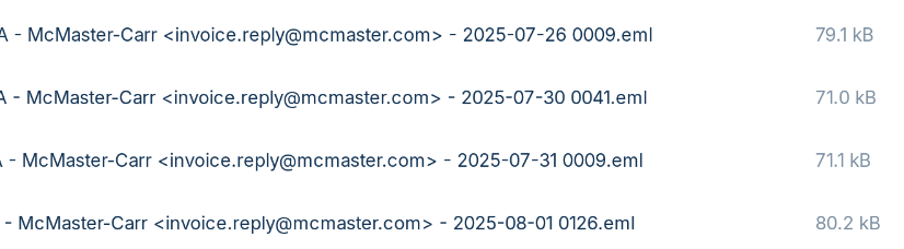

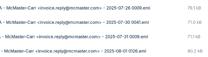

Hmm. The network share is formatted as ReFS rather than NTFS, but I just did some searching and it appears that ReFS has the same limitation on angle brackets in file names. Which is very odd considering the SMB share has files saved on the drive right now that contain angle brackets from my testing using the fstab mount method:
I went over to the Windows computer hosting the SMB share and when viewing those same files it appears that Windows believes the < is "scissors" and > is "a pair of glasses". So like you said, when the SMB share is mounted in the file system Nautilus is "handling it" in the background and simply changing the angle brackets to different characters without the knowledge of the user's direct involvement. Which I suppose is simply the solution I will have to go with, though I do find it curious that Thunderbird would try to use known illegal characters on some file systems by default on the Linux version of the program :man_shrugging:
They are using angle brackets because that is what the specification for what an email address is uses:
While there are other forms that could be used, as described in section 3.4.1 of that document, that form allows for characters that are also illegal to use anyway:
It's Windows that's at fault here due to this limitation, which is why Thunderbird uses another, non-standard, format for Windows. But it's hard to blame Windows for this, since it's basically impossible to accommodate every file system out there in every regard.
When working across file systems, it's always necessary to have something that can translate this little nuances on each end. Which may not always look the same or consistent depending on how it's implemented.
The file manager in Zorin OS uses it's own internal implementation at the application level, which is why it doesn't work for other programs. Mounting the drive through /etc/fstab would solve that problem by letting the OS handle this instead.
