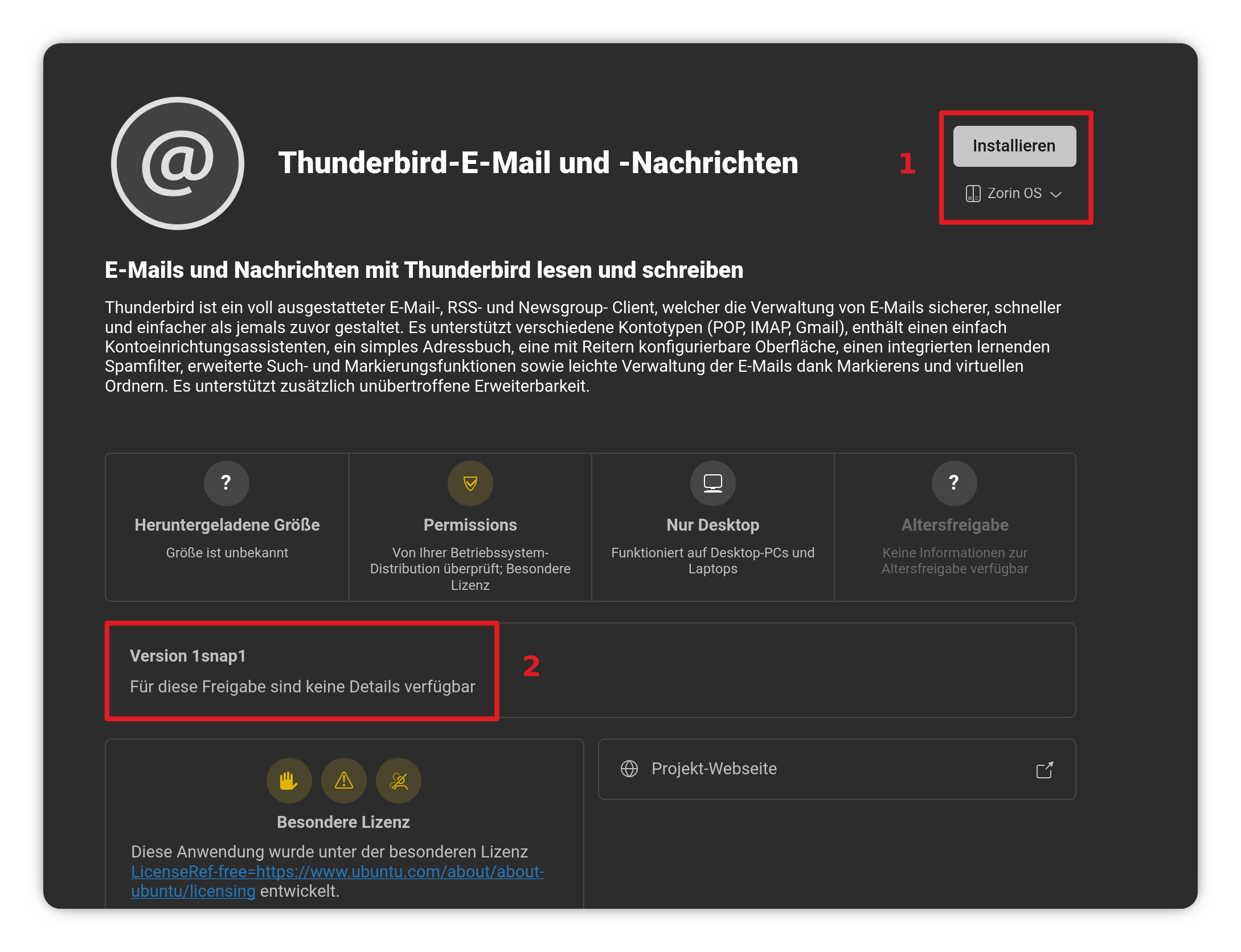

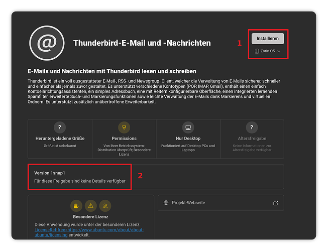

Unfortunately that doesn't have to mean that it is the .deb Package because Ubuntu (the Base of Zorin) tricks here and installs the Snap Package. Please go in Gnome Software and there to the Thunderbird Software Page. Under the Install Button, You see ''Zorin OS'' but a bit down for the actual Version, you see that the Snap Package is mentioned:
It currently says 1snap1, so you might be right. But I cannot tell what it was before the upgrade.
We have heard multiple reports, at this point... That the Ubuntu base has been replacing APT installed FireFox and Thunderbird with Snap versions, without consent or notification.

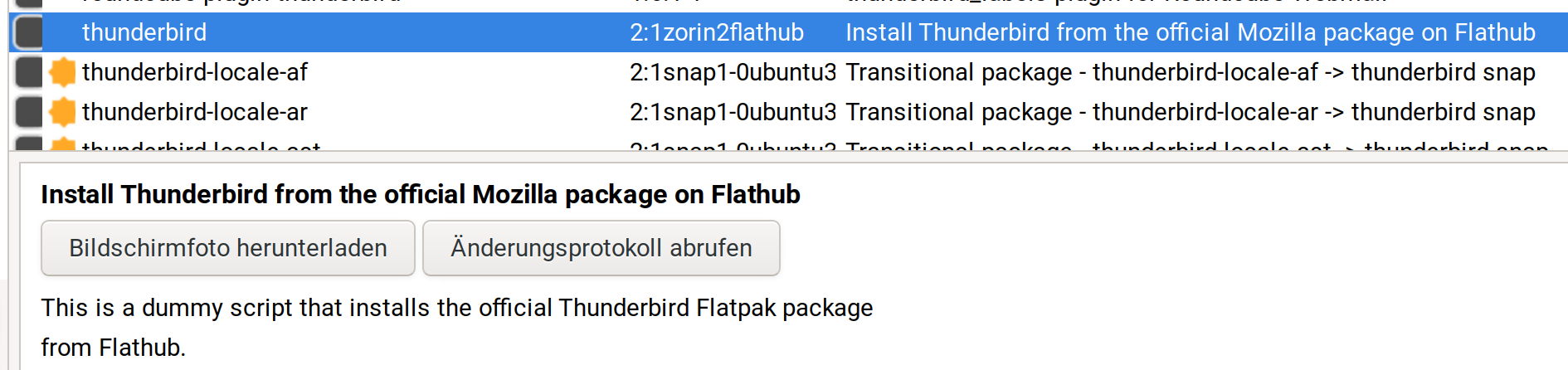

But when You use Synaptic on Zorin 18, You get this:
It seems that the Zorin Dev's have made a Transitional Package to install instead of the Snap Package from Ubuntu the official Flatpak. They should've announce that with a Blog Post.
That isn't what I got but will need to check again later. Will provide screenshot.
Snap or Flatpak packages can be installed through Synaptic or through terminal using apt if there is a MetaPackage that redirects to it.
That is a metapackage, not he package for the software itself.

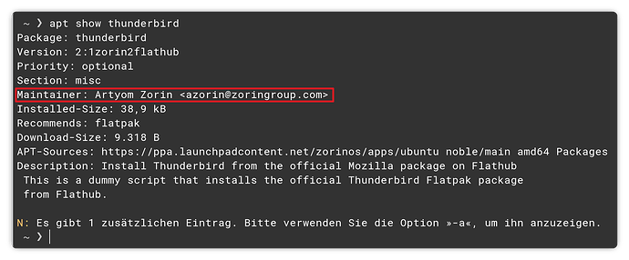

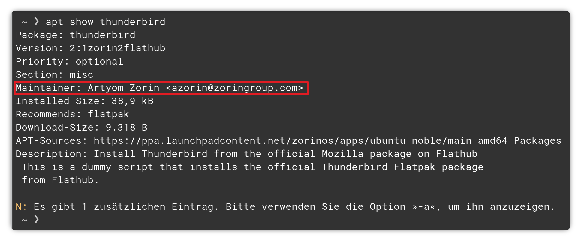

This here actually comes from the Zorin Dev's. You can see the zorin Addition in the Version Name/Number and when You type in the Terminal apt show thunderbird You can see how the Maintainer is:
My Interpretation of this would be that the Dev's have with this adressed the Thunderbird Snap Thing what we have here already discussed. But I don't know how long this is available.
