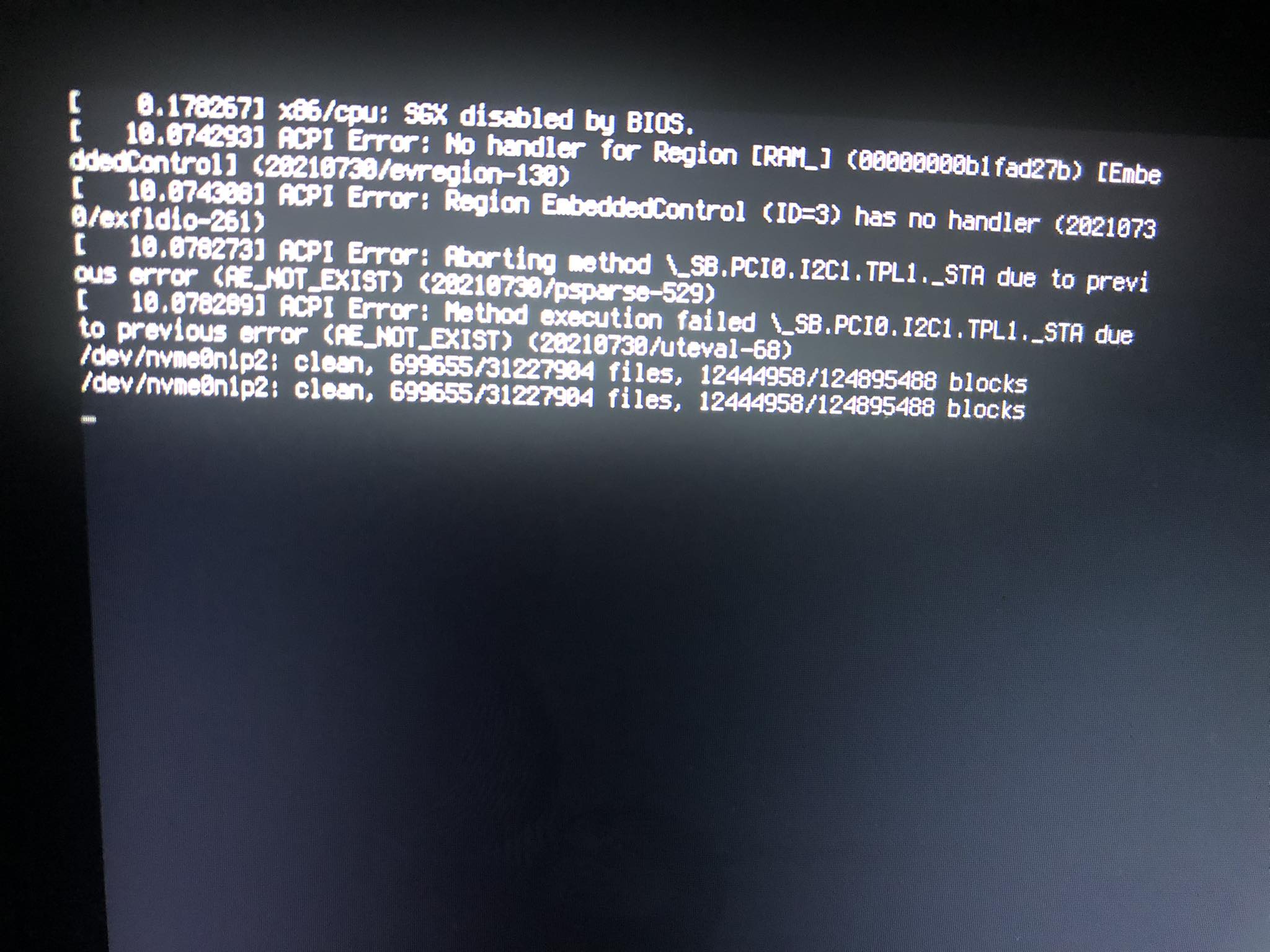

Looks like a kernel issue for someone else.. I'm not sure how to diagnose though. I would think maybe something with PXE boot? Seems like it's trying to probe hardware through those ports; for what, beyond me. Maybe a legacy USB setting? This is very intriguing.. Have you looked through BIOS for anything odd in your boot order?
Hello, Everything is ok with the boot order. This is what I have when I don't have something plugged in the usb-c port.
This is very strange. The ACPI errors relate to the ACPI tables (Motherboard /hardware) and should be present whether you have anything plugged into the USB-C port or not.
As you can see on the timestamps for the ACPI errors, they are very close together prior to initialization of graphics or essential drivers. So they are not causing No Boot.
I did find a bug report on the 5.15 kernel that details this issue.
