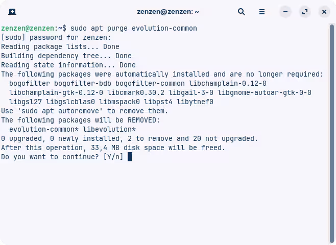

Does this also apply to "Recommended" dependencies? I've managed to uninstall Evolution and still reboot normally:

When You uninstall Evolution normally, there shouldn't be a Problem. It seems that the Data server Dependencies are not affected from a normal Uninstallation.
So, when You type sudo apt purge evolution it only removes the Evolution Mail Stuff. When You use instead evolution-common I'm not sure.
It doesn't seem to be a problem, either. I wonder if there was something else being removed for some reason?
@zenzen and @Ponce-De-Leon, the package that Gnome depends on is evolution-data-server
So removing just evolution should remove only the GUI App for Evolution mail.
But, if the underlying libraries were changed to auto installed, then the evolution-data-server package may get listed later for autoremove.
Or, if a person was looking through packages that were listed, like in Synaptic - and checkmarked all packages that bore the evolution- name...
