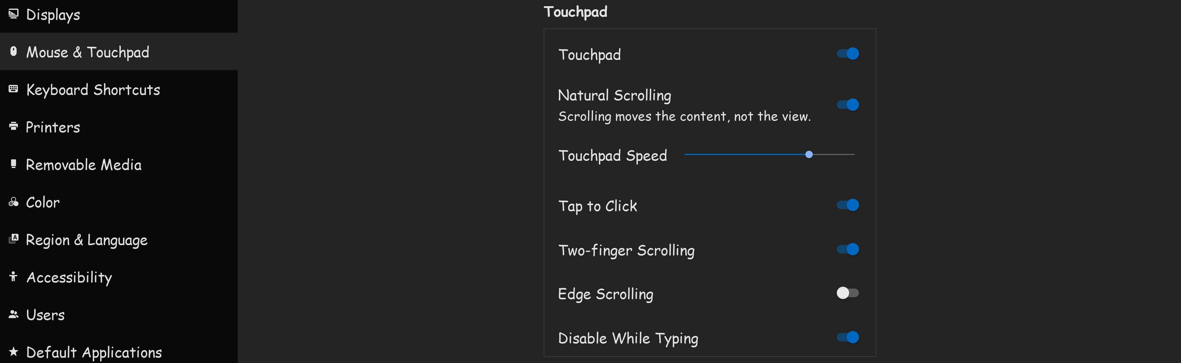

Click Zorin :zorin: icon bottom of screen, go to settings. :gear: Click on Mouse & Touchpad...
Turn off, "Two-Finger Scrolling"

Yeah, that happens sometimes on Zorin + it's usually just the touchpad driver acting up. You do not have to reboot every time, just close the lid for a few seconds or log out and back in - that usually resets it. Disabling "tap to click" in settings also helps reduce how it happens.
