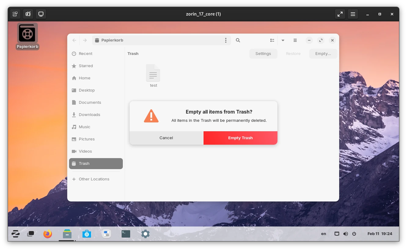

The problem is: The moment I move a file to the trashcan, the icon remains the empty trashcan. I can navigate through the file in the trashcan and empty it completely normally. Removing the icon and add it again was my first thought. Unfortunately it didn't work.
@Aravisian
The icons are, where they are supposed to be and the names are correct. The only problem is the icon doesn't change from the empty to the filled trashcan the moment I move (delete) a file there...
