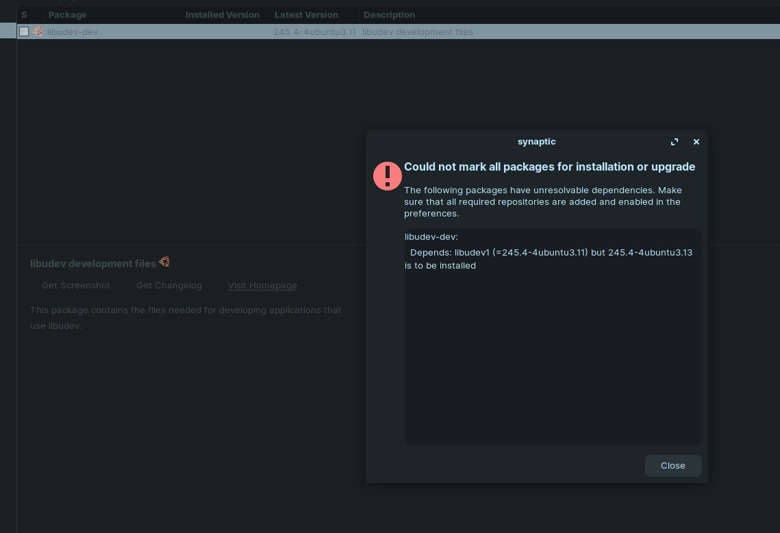

Or you could also do step 1 on Synaptic and just install the packages from there. Basically, skip the terminal.
I tried with Synaptic but got the same error
