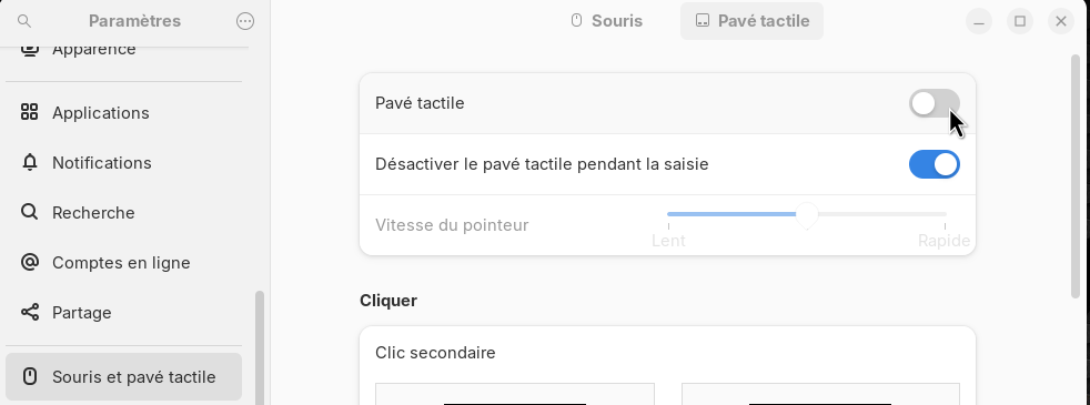

Settings --> Mouse and Touchpad --> Touchpad “off”
I still want to use the touchpad and read that there is a feature to stop it from operating while typing.
I can't find this option, so perhaps it is only available with the Pro?
In the settings, you can choose between “always on” or “always off” for Core and Pro.
The second field there at touchpad should disable the touchpad while typing.
Perhaps it doesn't work on all devices. I read that a user reported that it didn't help to enable this function there.
You're right, I was too quick to answer.
I need new glasses, I see it now.
It is already on. I've turned it off and back on again. It might not have engaged correctly before.
