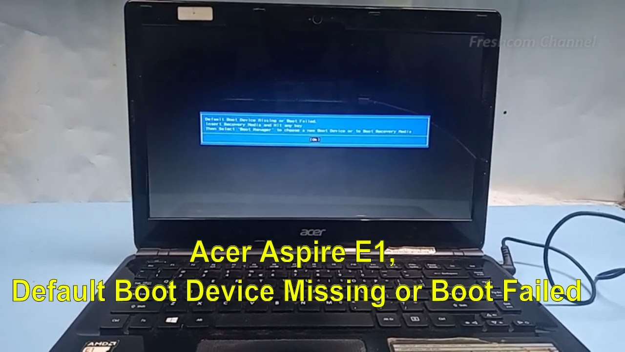

I have installed Zorin OS 16 and i get this information below:
Default Boot Device Missing Or Boot Failed.
Insert Recovery Media and Hit any Key
Then Select 'Boot Manager' to choose a new Boot Device or to Boot Recovery Media.
After that:
Option Menu
1.Unkown Device: (WDC WD5000LPCX-21VHAT0)
2.Yes
Up and down to change option, ENTER to select an option, ESC to exit
I selected option 1 unknown device and it starts.
I have done that but why is this ugly text keep showing i had a nice startup with the text Zorin when i had 15.3 now i have this ugly text is it something wrong i have done??
But how do i remove this ugly text?
