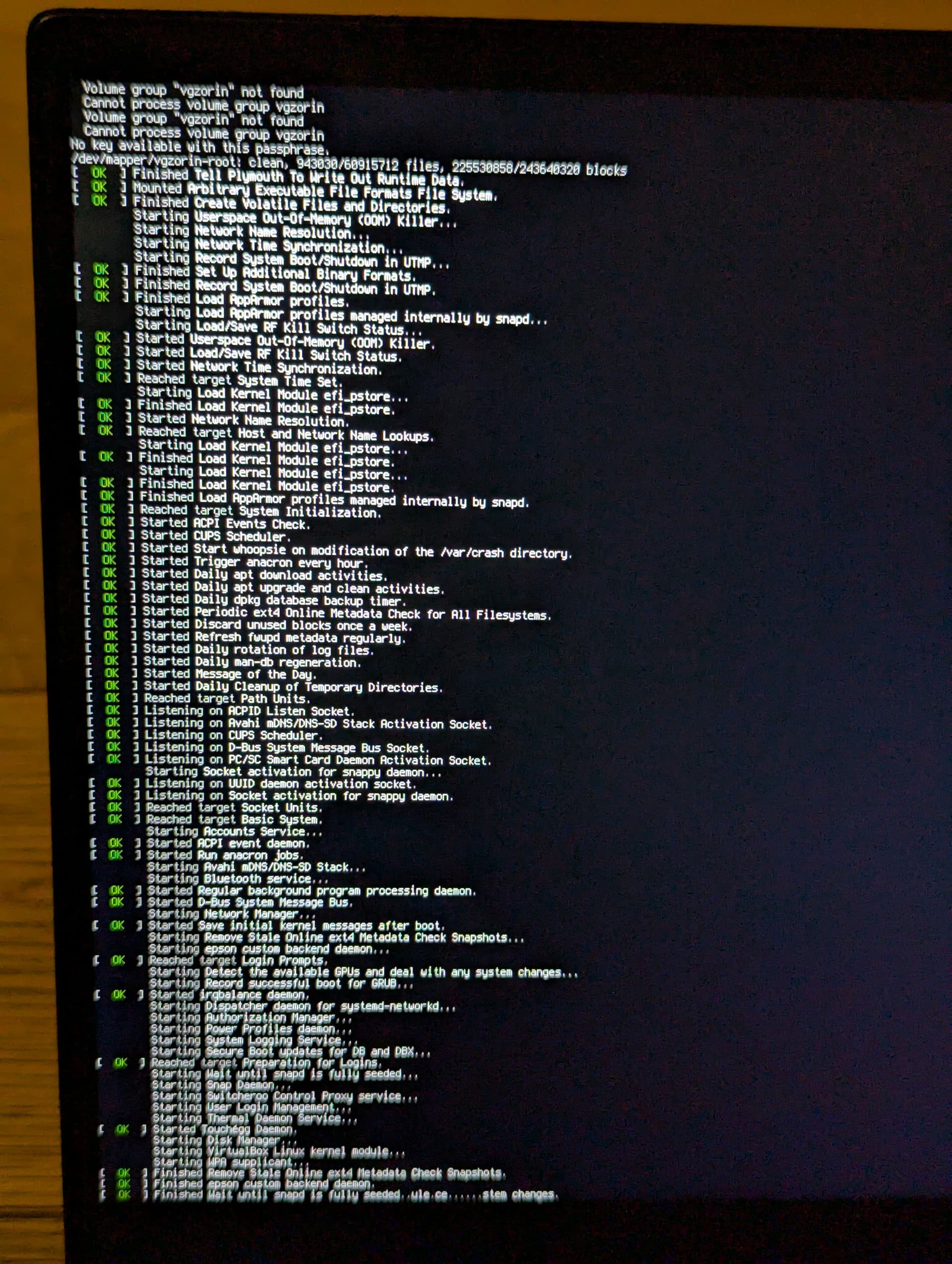

after I removed libreoffice-gtk3, ZorinOS won't boot anymore. After unlocking the encrypted drive (LVM) successfully, the zorin logo appears, then disappears and this screen is seen. Does anyone know the problem and how to fix it?

If you have access to a command prompt after that screen, you can try running:
sudo apt install zorin-os-desktop
Once it's done installing that, restart by typing reboot.

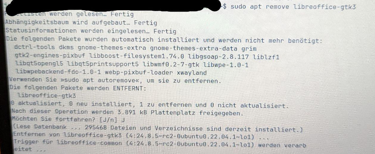

That's the last command I did before I rebooted and got the described issue (sorry, it's in German).
It basically says that the package "libreoffice-gtk3" got removed.
I just did a test:
sudo apt remove libreoffice-gtk3                                                               ─╯
[sudo] password for mech-1:
Reading package lists... Done
The following package was automatically installed and is no longer required:
  libgtkmm-2.4-1v5
Use 'sudo apt autoremove' to remove it.
The following packages will be REMOVED:
  libreoffice-gtk3
I see yours lists dkms and xwayland, which I know for certainty have no dependency with libreoffice-gtk3 package.
