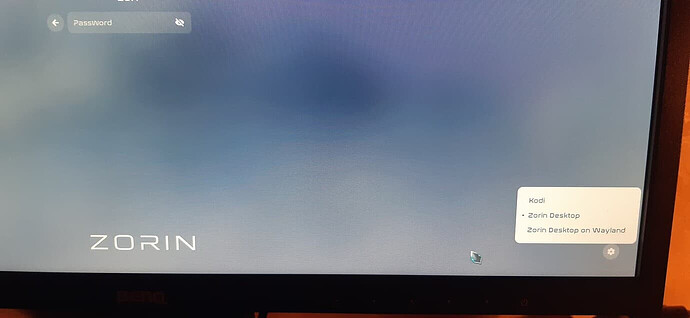

Additionally, make sure you have Secure Boot disabled in your computer's BIOS. Then, once you do that, upon at login screen, click on your name, and click the gear icon :gear: and select Zorin OS desktop, not Wayland!
