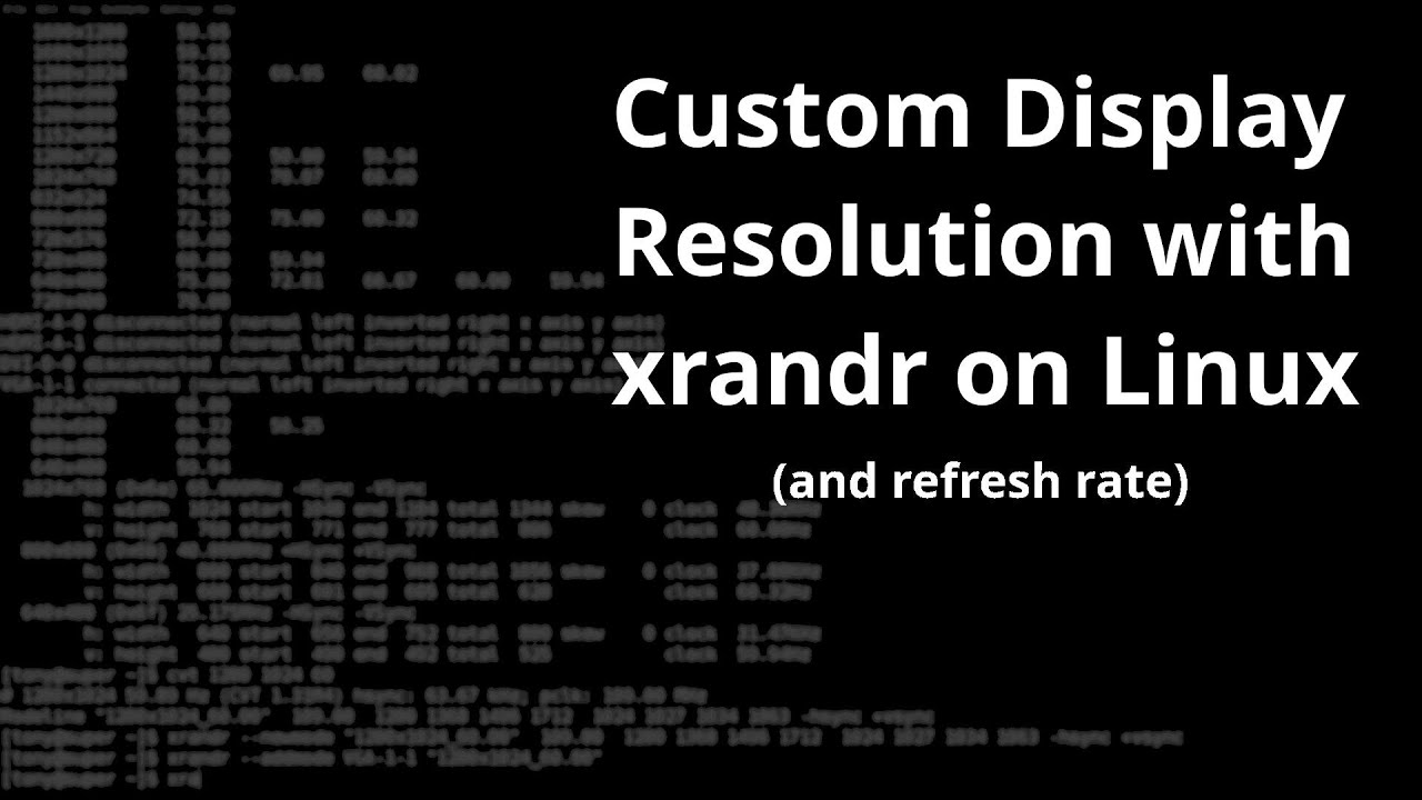

You should check if zorin runs in X11 or Wayland. Take a Look in Settings>About for this. If it is Wayland, You should switch to X11/Xorg.
To do this, go to the Login Screen (not the Lock Screen). Simply reboot for this. On the Login Screen click on Your Profile so that the Password Field appears. It has to be appeared. When it is appeared, You should see a Gear Icon in the bottom right Corner. click on it and choose ''Zorin Desktop on Xorg'' and then log in and check if You can change it. If not, stay on Xorg and try it with xrandr. Here is a little Tutorial Video:
