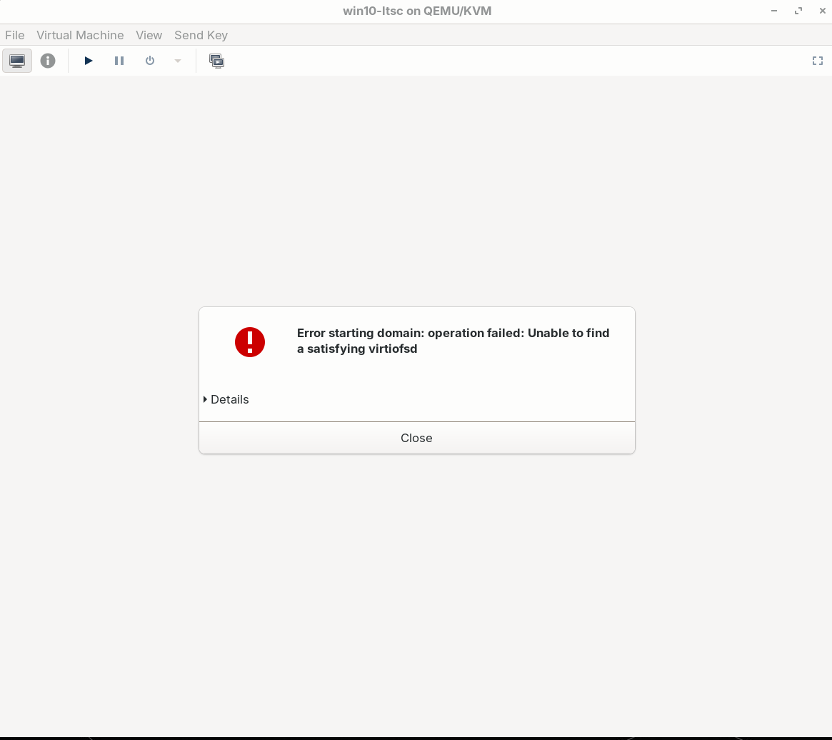

I tried to fix it using this article but got an error when I tried to start the guest. The error is "Error starting domain: operation failed: Unable to find a satisfying virtiofsd". Searching the web for the error yields nothing.

Thanks but I did that. When I start the vm I get the error "Error starting domain: operation failed: Unable to find a satisfying virtiofsd". So I'm unable to install Winfsp and enable the service.

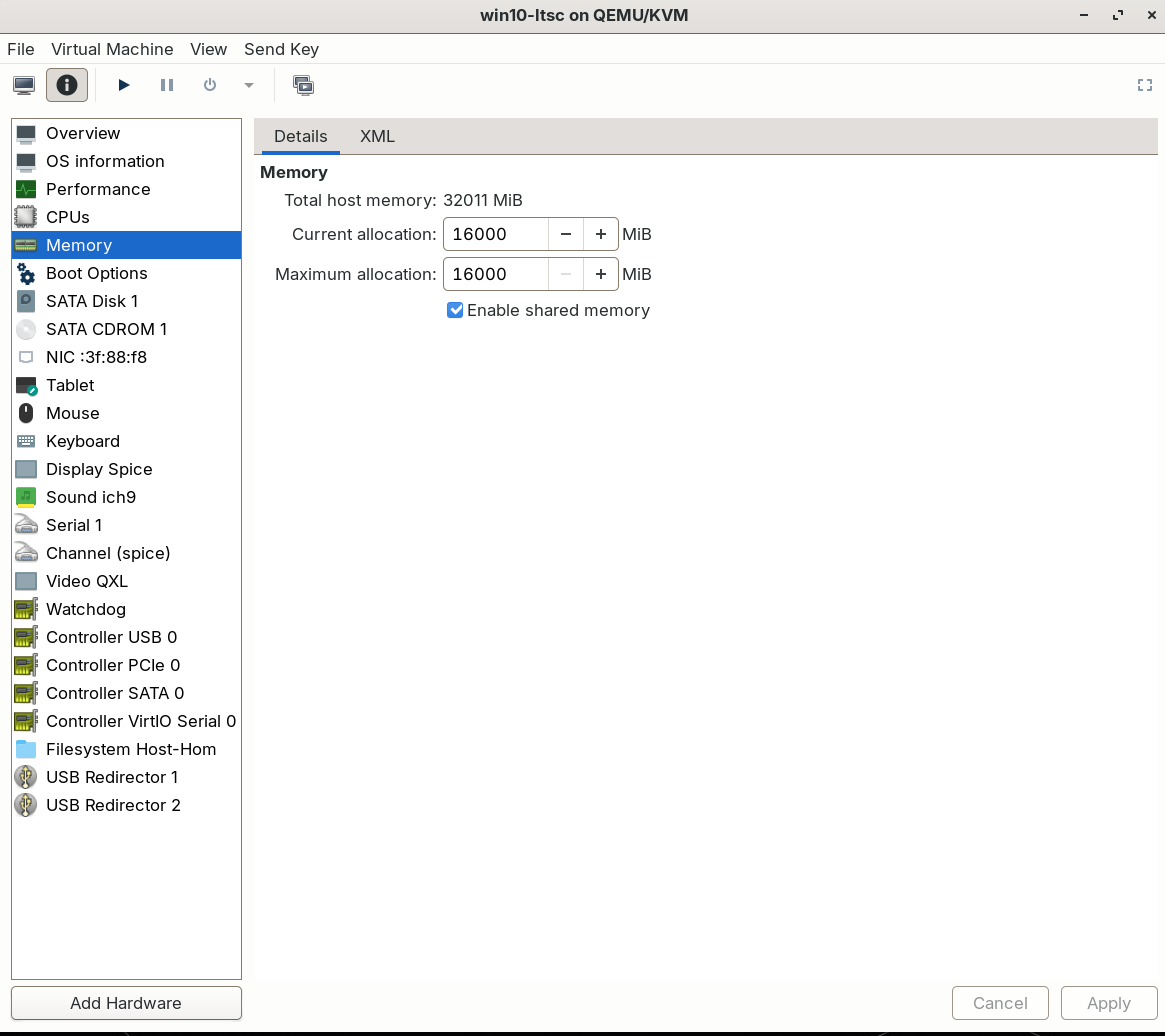

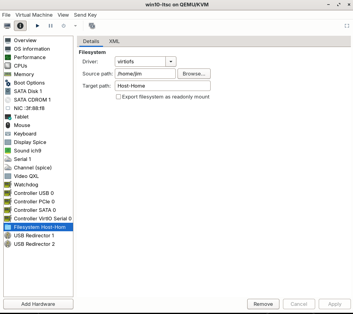

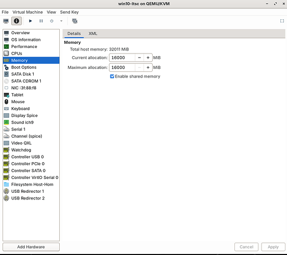

I tried installing the service in the vm first and then enabled Shared Memory and setup the filesystem but no joy.
I'm not sure but I think it's the virtiofsd package that's missing. I would've thought this is installed with virtual machine manager, so let's double check:
sudo apt install virtiofsd
You might need to restart to apply it correctly.
Great. That got me past the error when I launch the VM.

I've never ran Windows guests from KVM, so I don't know what else might be missing. With Linux distributions, enabling the shared memory and creating that virtual mount point is enough.
