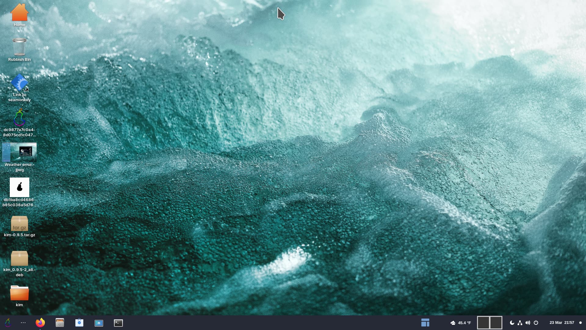

I would advise you use Virt-Manager instead. I only get small screen at login but I get it full screen once logged in (Have taken a screenshot with box at top to allow to shrink as windowed VM:
Desktop quality is far superior to Virtual Box - I won't go back to VB!
Oops! took screenshot using Zorin Guest! This is what you should have seen:
