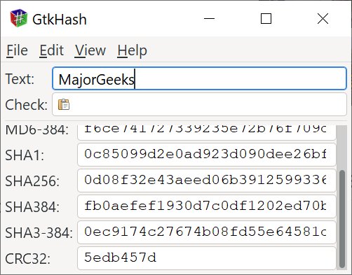

If you can download the text from your first link then submit it here and then use the link it generates. Personally I prefer Ventoy as a USB installer. You can use GtkHash for checksums, it is OS agnostic.
