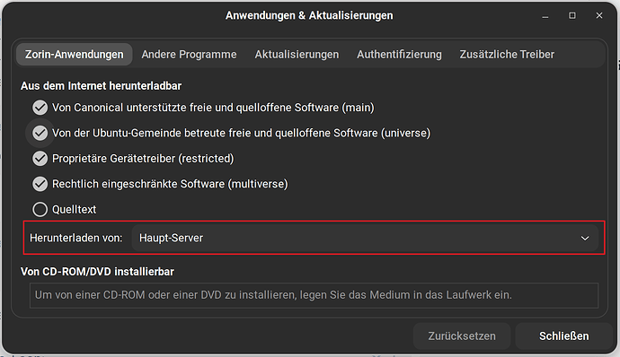

Okay, try the Following:
Open Software & Updates and on the first Tab choose as Source ''Main Server'':
Alright I did that.
