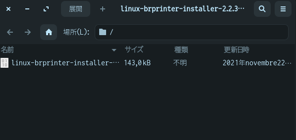

I only get a single installer file showing in Archiver and extract only a single file.

I double click to extract installer (single file) and run the installation script in terminal to install all drivers in one go.
What surprised me was that Archive cannot open the compressed file.
