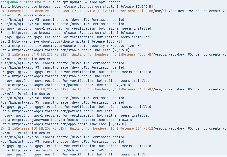

Hi, new user of Zorin OS here. Having some issues running any updates (via apt-get or the inbuilt software updater). I am receiving multiple permissions and other errors. I have tried various fixes from around the web to no avail. Attached are screenshots of some of the errors as well as the output of the troubleshooting steps from this page - Fix Package Manager Issues - Zorin Help
Any help would be much appreciated!

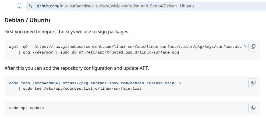

The surface kernel repository is suitable for debian and ubuntu (here you can see the installation guide):

Looks like a Mixture of Permission Issues and GPG Verification Failes ...

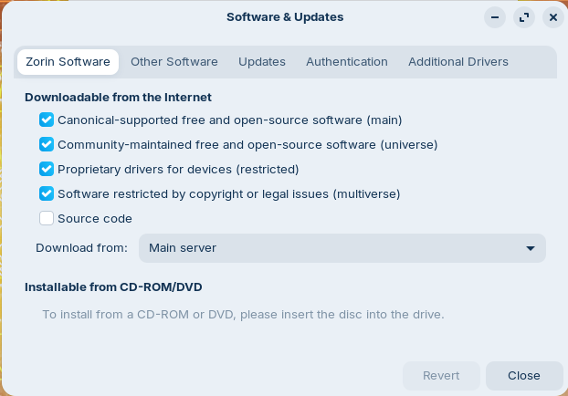

First, I would suggest to go to Software & Updates and set there the Source to ''Main Server'' and then try it again. If that shouldn't help, you might need to download the gpg Package/s manually but first try what I wrote.

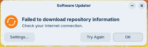

Thank you for the reply. I have already tried setting main server as the source without luck. How can I manually add the gpg packages? I tried doing that the other day based on some googling without luck (apologies, I'm not very familiar with Linux)
No, you don't need to run these commands when you followed an installation guide, e.g. this one here
You have already added this repository for the Linux Surface kernel. I just wanted to show that it's not a problem here that "debian" is mentioned in the name and not Ubuntu.

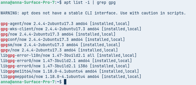

Check if the gpg package is installed with
apt list -i | grep gpg
and post the output here.

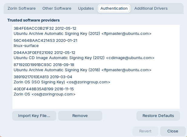

Would you please also make a screenshot of Software & Updates > Authentication?

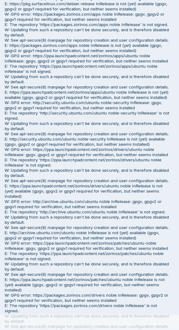

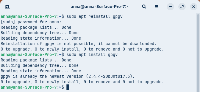

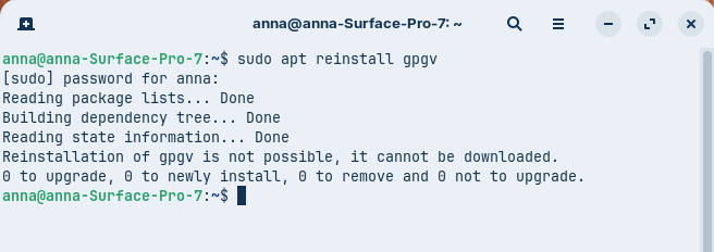

The Error mentioned You need one of them. It took a Look and on Zorin 18 seems gpgv be preinstalled. And because of Your Error Message it seems to be missed.
I would suggest the Following for the Case that it is installed but not recognized to type in the Terminal:
sudo apt reinstall gpgv
That will reinstall the Package when it is already installed. When this shouldn't work because it isn't installed, You can install it with:
sudo apt install gpgv
After that reboot and then type in the Terminal sudo apt update && sudo apt upgrade

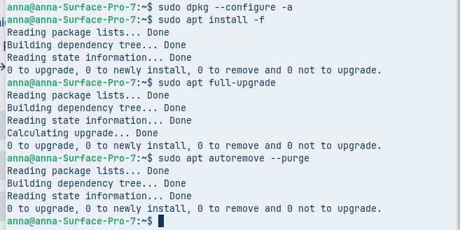

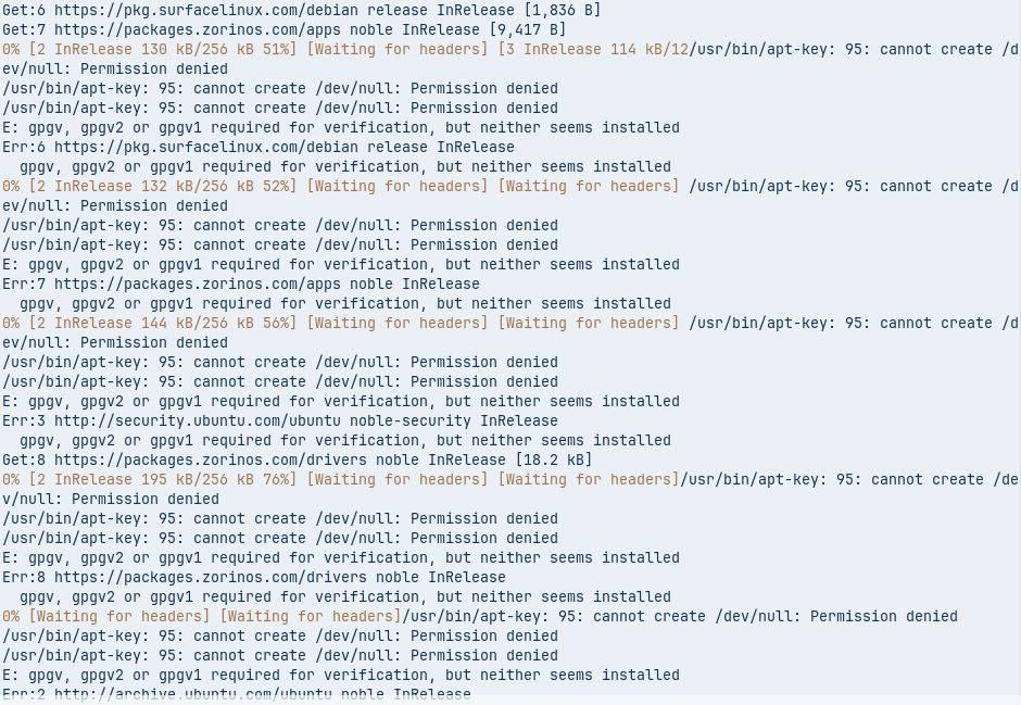

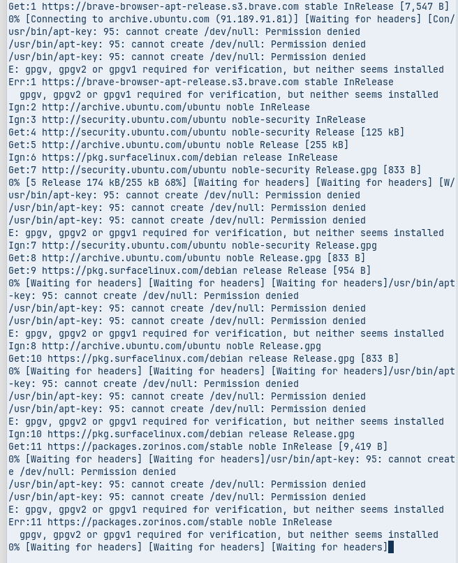

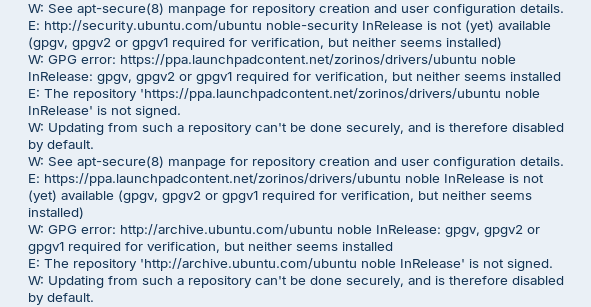

Thanks for the replies and sorry for the late response!

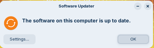

I have tried the above suggestions without success, screenshots below:
Reinstalling GPGV:
Results of apt list -i | grep gpg:
Screenshots of Software Updater and settings:
Ends with saying software is up to date despite it not working:

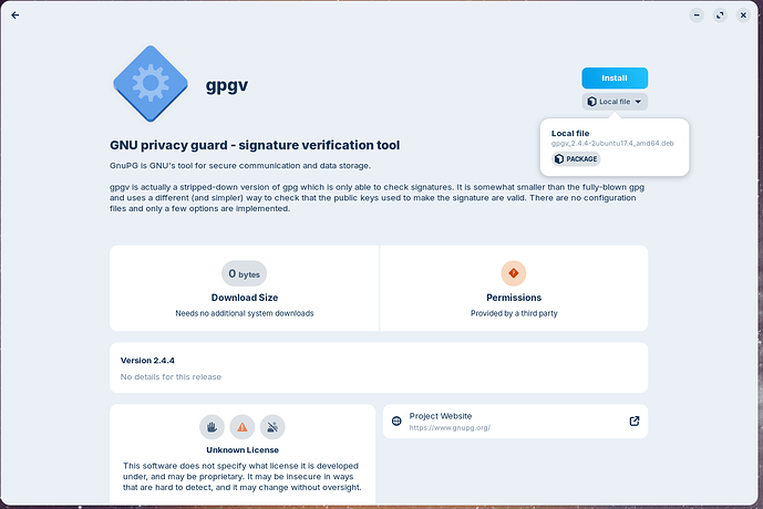

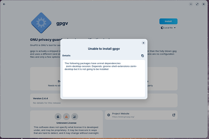

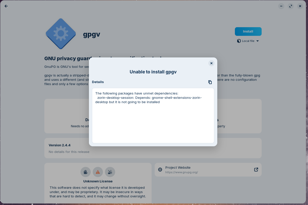

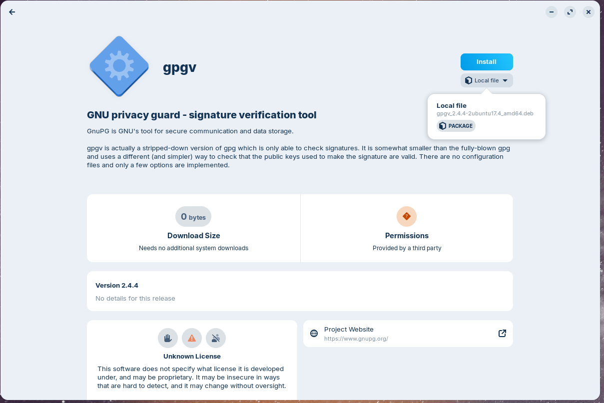

Maybe try it with manually download the Package and install it:
Look there for the File gpgv_2.4.4-2ubuntu17.4_amd64.deb
I tried that, unfortunately no success still (see attached). I'm thinking of turning off secure boot and reinstalling from scratch at this point if a solution can't be found (or trying Ubuntu). Interestingly, Flatpack installs from Zorin Package Manager seem to be working ok (installed AbiWord and Brave without issue)?

The gpgv package is installed and this is shown true in your screenshots.
However, authentication is failing and the system, which cannot question or think - fallsback to a predefined text result that assumes the package must be missing (it is not missing).

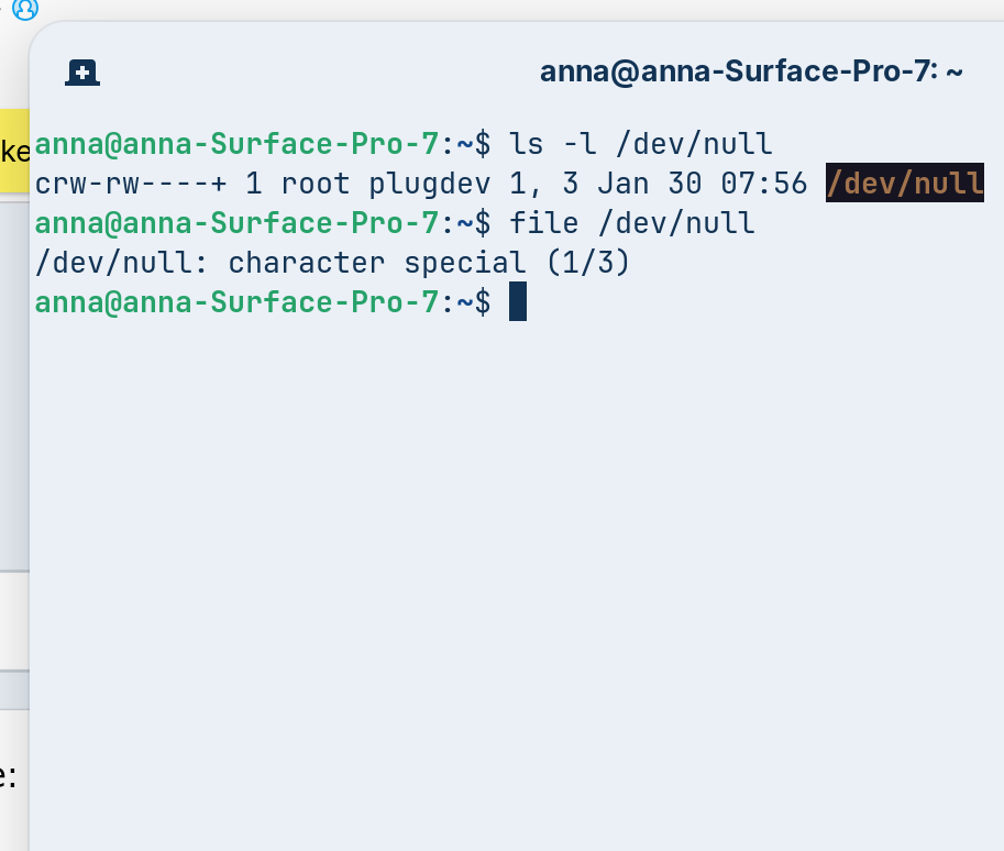

What is your terminal output for:
ls -l /dev/null
and:
file /dev/null
Attached are the results of those commands.
Your output shows:
crw-rw----+ 1 root plugdev 1, 3 < here is your problem. It must be owned by root., not 'plugdev'
In terminal run each of these:
sudo setfacl -b /dev/null
sudo chown root:root /dev/null
sudo chmod 666 /dev/null
To assign ownership and permissions to root.
Check:
ls -l /dev/null
It should match exactly:
crw-rw-rw- 1 root root 1, 3 /dev/null
How that happened - I have no idea. If you recall doing any scripts or changes - that may have created a udev rule that can revert this after today, please let us know.
Once the above is done, test with the upgrade command in terminal.

/lib/udev/rules.d/60-libgphoto2-6t64.rules:KERNEL=="sg[0-9]", ATTRS{idVendor}=="04b0", ATTRS{idProduct}=="010e", ENV{ID_GPHOTO2}="1", ENV{GPHOTO2_DRIVER}="proprietary", MODE="0664", GROUP="plugdev"
", ATTRS{idVendor}=="04b0", ATTRS{idProduct}=="0104", ENV{ID_GPHOTO2}="1", ENV{GPHOTO2_DRIVER}="proprietary", MODE="0664", GROUP="plugdev"
/lib/udev/rules.d/60-libgphoto2-6t64.rules:KERNEL=="sg[0-9]", ATTRS{idVendor}=="04b0", ATTRS{idProduct}=="0401", ENV{ID_GPHOTO2}="1", ENV{GPHOTO2_DRIVER}="proprietary", MODE="0664", GROUP="plugdev"
", ATTRS{idVendor}=="07b4", ATTRS{idProduct}=="0105", ENV{ID_GPHOTO2}="1", ENV{GPHOTO2_DRIVER}="proprietary", MODE="0664", GROUP="plugdev"
/lib/udev/rules.d/60-libgphoto2-6t64.rules:KERNEL=="sg[0-9]", ATTRS{idVendor}=="07b4", ATTRS{idProduct}=="0105", ENV{ID_GPHOTO2}="1", ENV{GPHOTO2_DRIVER}="proprietary", MODE="0664", GROUP="plugdev"
/lib/udev/rules.d/60-libgphoto2-6t64.rules:KERNEL=="sg[0-9]", ATTRS{idVendor}=="07b4", ATTRS{idProduct}=="0109", ENV{ID_GPHOTO2}="1", ENV{GPHOTO2_DRIVER}="proprietary", MODE="0664", GROUP="plugdev"
/lib/udev/rules.d/60-libgphoto2-6t64.rules:KERNEL=="sg[0-9]", ATTRS{idVendor}=="25fb", ATTRS{idProduct}=="0130", ENV{ID_GPHOTO2}="1", ENV{GPHOTO2_DRIVER}="proprietary", MODE="0664", GROUP="plugdev"
", ATTRS{idVendor}=="25fb", ATTRS{idProduct}=="0178", ENV{ID_GPHOTO2}="1", ENV{GPHOTO2_DRIVER}="proprietary", MODE="0664", GROUP="plugdev"
/lib/udev/rules.d/60-libgphoto2-6t64.rules:KERNEL=="sg[0-9]", ATTRS{idVendor}=="0a17", ATTRS{idProduct}=="0070", ENV{ID_GPHOTO2}="1", ENV{GPHOTO2_DRIVER}="proprietary", MODE="0664", GROUP="plugdev"
", ATTRS{idVendor}=="0a17", ATTRS{idProduct}=="00a1", ENV{ID_GPHOTO2}="1", ENV{GPHOTO2_DRIVER}="proprietary", MODE="0664", GROUP="plugdev"
/lib/udev/rules.d/60-libgphoto2-6t64.rules:KERNEL=="sg[0-9]", ATTRS{idVendor}=="0a17", ATTRS{idProduct}=="006e", ENV{ID_GPHOTO2}="1", ENV{GPHOTO2_DRIVER}="proprietary", MODE="0664", GROUP="plugdev"
", ATTRS{idVendor}=="0a17", ATTRS{idProduct}=="0093", ENV{ID_GPHOTO2}="1", ENV{GPHOTO2_DRIVER}="proprietary", MODE="0664", GROUP="plugdev"
/lib/udev/rules.d/60-libgphoto2-6t64.rules:KERNEL=="sg[0-9]", ATTRS{idVendor}=="0a17", ATTRS{idProduct}=="0091", ENV{ID_GPHOTO2}="1", ENV{GPHOTO2_DRIVER}="proprietary", MODE="0664", GROUP="plugdev"
", ATTRS{idVendor}=="25fb", ATTRS{idProduct}=="0164", ENV{ID_GPHOTO2}="1", ENV{GPHOTO2_DRIVER}="proprietary", MODE="0664", GROUP="plugdev"
/lib/udev/rules.d/60-libgphoto2-6t64.rules:KERNEL=="sg[0-9]", ATTRS{idVendor}=="25fb", ATTRS{idProduct}=="0132", ENV{ID_GPHOTO2}="1", ENV{GPHOTO2_DRIVER}="proprietary", MODE="0664", GROUP="plugdev"
", ATTRS{idVendor}=="25fb", ATTRS{idProduct}=="017a", ENV{ID_GPHOTO2}="1", ENV{GPHOTO2_DRIVER}="proprietary", MODE="0664", GROUP="plugdev"
/lib/udev/rules.d/60-libgphoto2-6t64.rules:KERNEL=="sg[0-9]", ATTRS{idVendor}=="25fb", ATTRS{idProduct}=="0160", ENV{ID_GPHOTO2}="1", ENV{GPHOTO2_DRIVER}="proprietary", MODE="0664", GROUP="plugdev"
", ATTRS{idVendor}=="25fb", ATTRS{idProduct}=="0102", ENV{ID_GPHOTO2}="1", ENV{GPHOTO2_DRIVER}="proprietary", MODE="0664", GROUP="plugdev"
/lib/udev/rules.d/60-libgphoto2-6t64.rules:KERNEL=="sg[0-9]", ATTRS{idVendor}=="25fb", ATTRS{idProduct}=="0148", ENV{ID_GPHOTO2}="1", ENV{GPHOTO2_DRIVER}="proprietary", MODE="0664", GROUP="plugdev"
", ATTRS{idVendor}=="25fb", ATTRS{idProduct}=="014a", ENV{ID_GPHOTO2}="1", ENV{GPHOTO2_DRIVER}="proprietary", MODE="0664", GROUP="plugdev"
/lib/udev/rules.d/60-libgphoto2-6t64.rules:KERNEL=="sg[0-9]", ATTRS{idVendor}=="25fb", ATTRS{idProduct}=="017c", ENV{ID_GPHOTO2}="1", ENV{GPHOTO2_DRIVER}="proprietary", MODE="0664", GROUP="plugdev"
", ATTRS{idVendor}=="25fb", ATTRS{idProduct}=="017e", ENV{ID_GPHOTO2}="1", ENV{GPHOTO2_DRIVER}="proprietary", MODE="0664", GROUP="plugdev"
/lib/udev/rules.d/60-libgphoto2-6t64.rules:KERNEL=="sg[0-9]", ATTRS{idVendor}=="0a17", ATTRS{idProduct}=="0009", ENV{ID_GPHOTO2}="1", ENV{GPHOTO2_DRIVER}="proprietary", MODE="0664", GROUP="plugdev"
", ATTRS{idVendor}=="0a17", ATTRS{idProduct}=="0007", ENV{ID_GPHOTO2}="1", ENV{GPHOTO2_DRIVER}="proprietary", MODE="0664", GROUP="plugdev"
/lib/udev/rules.d/60-libgphoto2-6t64.rules:KERNEL=="sd[a-z]", ATTRS{idVendor}=="1403", ATTRS{idProduct}=="0001", ENV{ID_GPHOTO2}="1", ENV{GPHOTO2_DRIVER}="proprietary", MODE="0664", GROUP="plugdev"
", ATTRS{idVendor}=="0168", ATTRS{idProduct}=="3011", ENV{ID_GPHOTO2}="1", ENV{GPHOTO2_DRIVER}="proprietary", MODE="0664", GROUP="plugdev"
