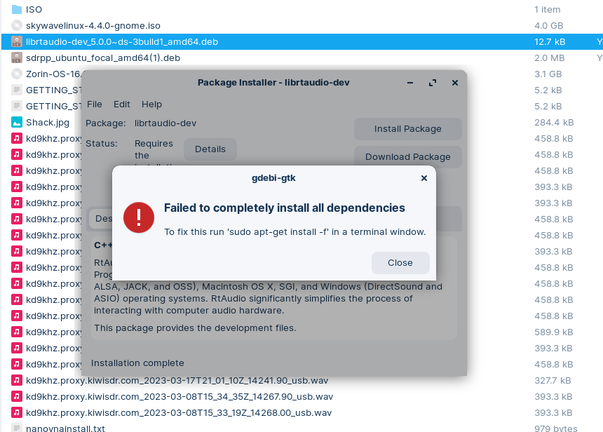

Here is the .deb package for librtaudio-dev:
http://archive.ubuntu.com/ubuntu/pool/universe/r/rtaudio/librtaudio-dev_5.0.0~ds-3build1_amd64.deb
I highly recommend using Gdebi
sudo apt install gdebi
Then right click the downloaded .deb package from above and select to open with Gdebi.
Once open, it should say at the top whether all dependencies are satisfied, whether additional packages need to be installed - or if the package cannot be installed due to unsatisfiable dependencies.
May as well try the sudo apt install -f command.
It's not my usual go to - since a missing dependency is a missing dependency... But it might work.
Its answer was to remove the package. This means that it cannot function without the dependencies.
