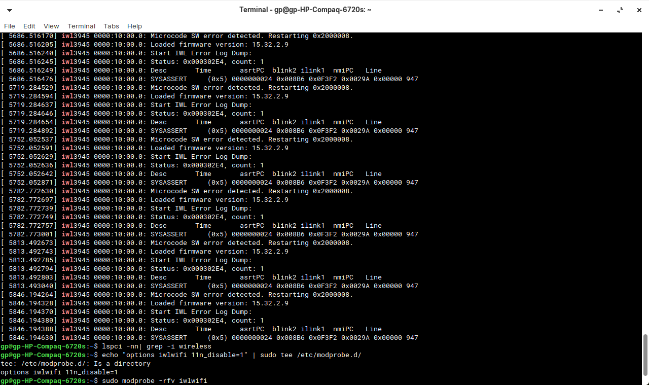

Hi FrenchPress
Tried the fix's suggested in your link. No further on, I'm afraid. Here are the screenshots from them. I think I have included them all. Many thanks.
Tim
Yes, the module was present in the kernel and it is using the iwlwifi module now. You may try a restart and then testing your wifi and hope it works...
