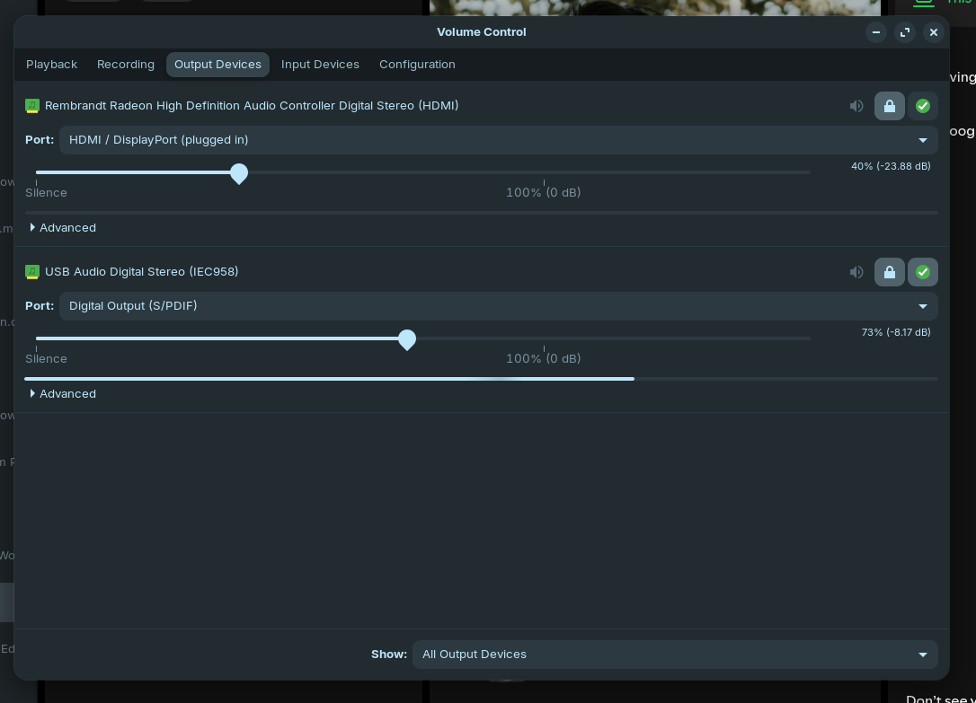

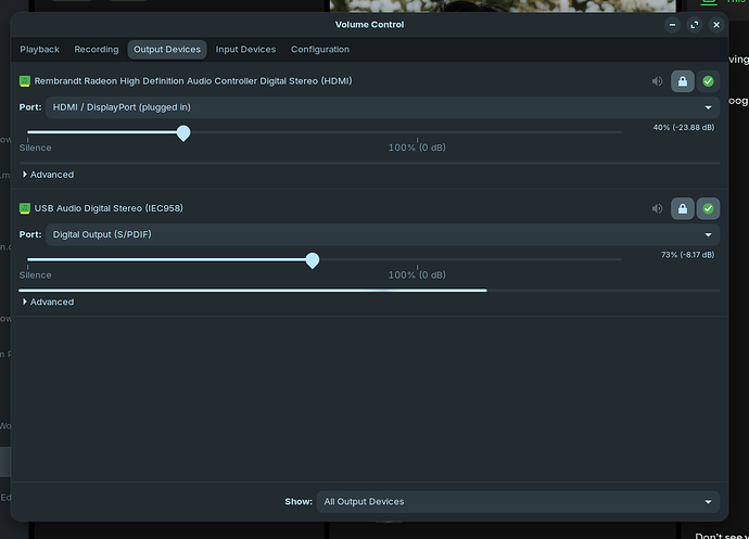

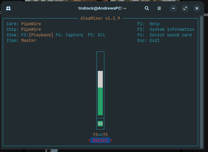

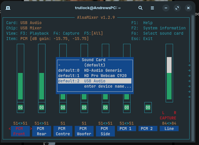

Nothing seems to be muted or low in alsamixer
I'm using the digital S/PDIF optical output to my hifi.
Interestingly, if i plug headphones into the line-out, I can hear the music playing. The Volume control still says Digital Output S/PDIF is the port, is that a red herring? Have ports become mismapped somehow?
What can I do?
Thanks

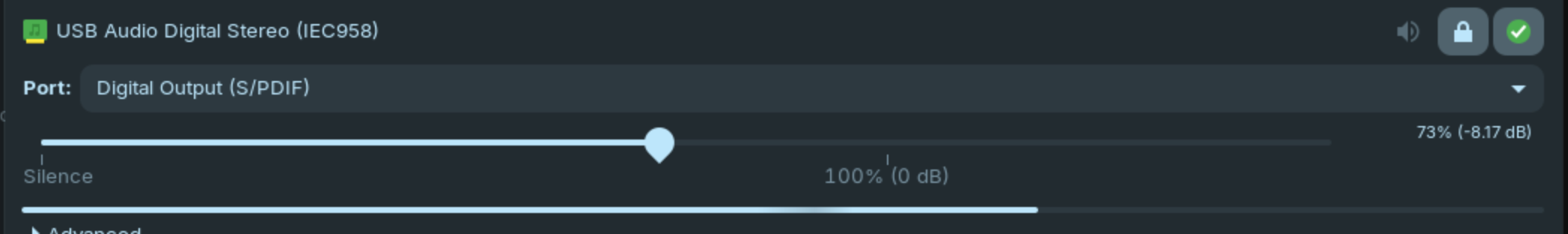

So, You use this as active Output, yes? When You click on the Dropdown Menu, what Options do You have? And when You go to the Configuration Tab what do You get there?
Digital Output S/PDIF is the only Port/Output option.

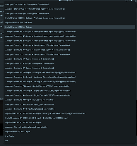

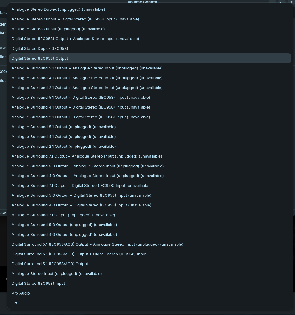

On configuration there is:
Highlighted one is selected, was the Duplex mode above.
Tried most of the others, S/PDIF optical out is no longer working, unless my hifi died at exactly the same time I did the kernel upgrade. Will see if I can find another device with an optical in to test it, but obviously highly unlikely
You could boot in the older Kernel to check if it works then. To do that, choose on Start-Up on the GRUB Menu ''Advanced Options'' and choose there the older Kernel. When logged in check if the Audio works again.
On Your List I saw these 2 Options:
grafik
Does one of these maybe work?
