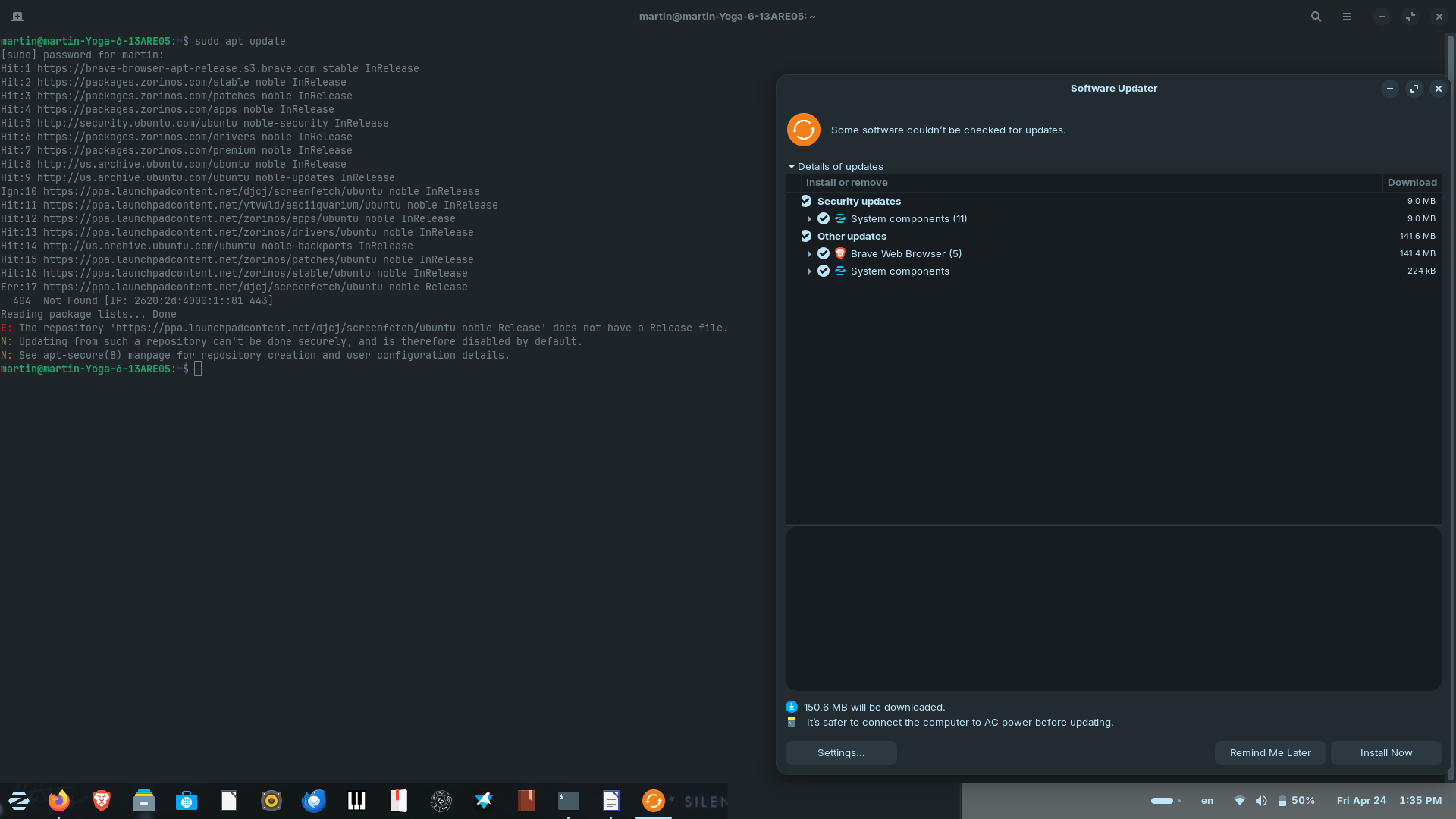

I've been dealing with this issue for a while but it sometimes scares me. Sometimes during start up my system will already have the software updater open trying to get me to do updates. However since I didn't open it myself I usually close it, restart my laptop and then open up the updater again. Doing so will show me a different list of updates from the ones shown before. Have I been hacked?
The Updater acts a little funky at times when I check for updates.

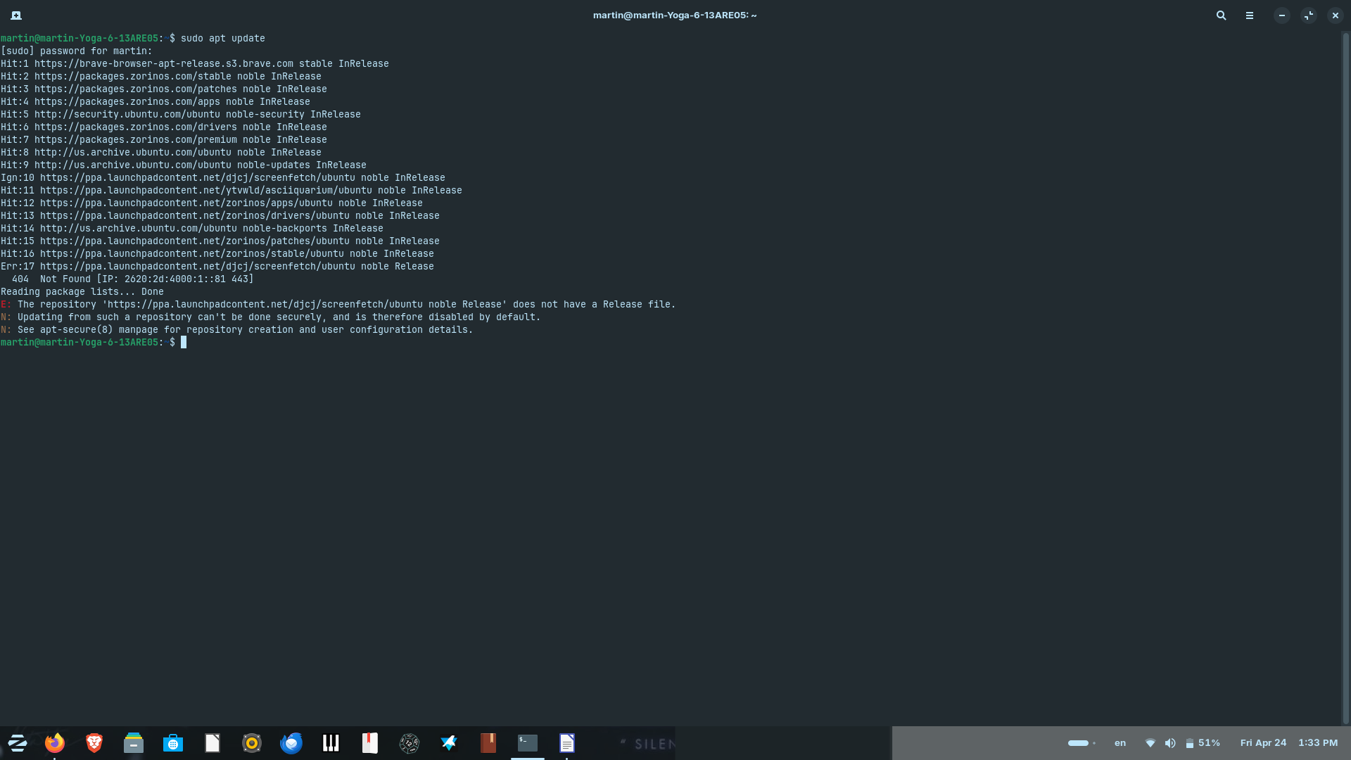

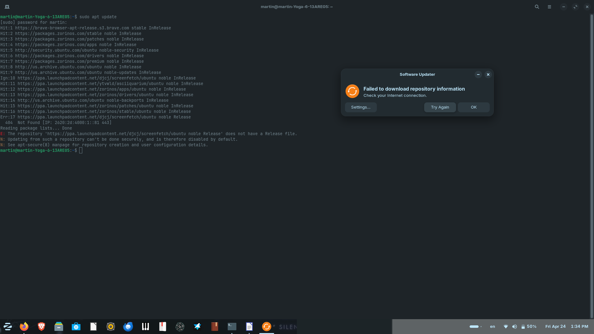

You do show that you have an added repository that is unsupported on Noble Numbat, however. Screenfetch has been deprecated - while the application still works fine, the repository is useless, now. I recommend removing that.
System Updates and the Upgrader can act a bit funky if you have added conflicting repositories.

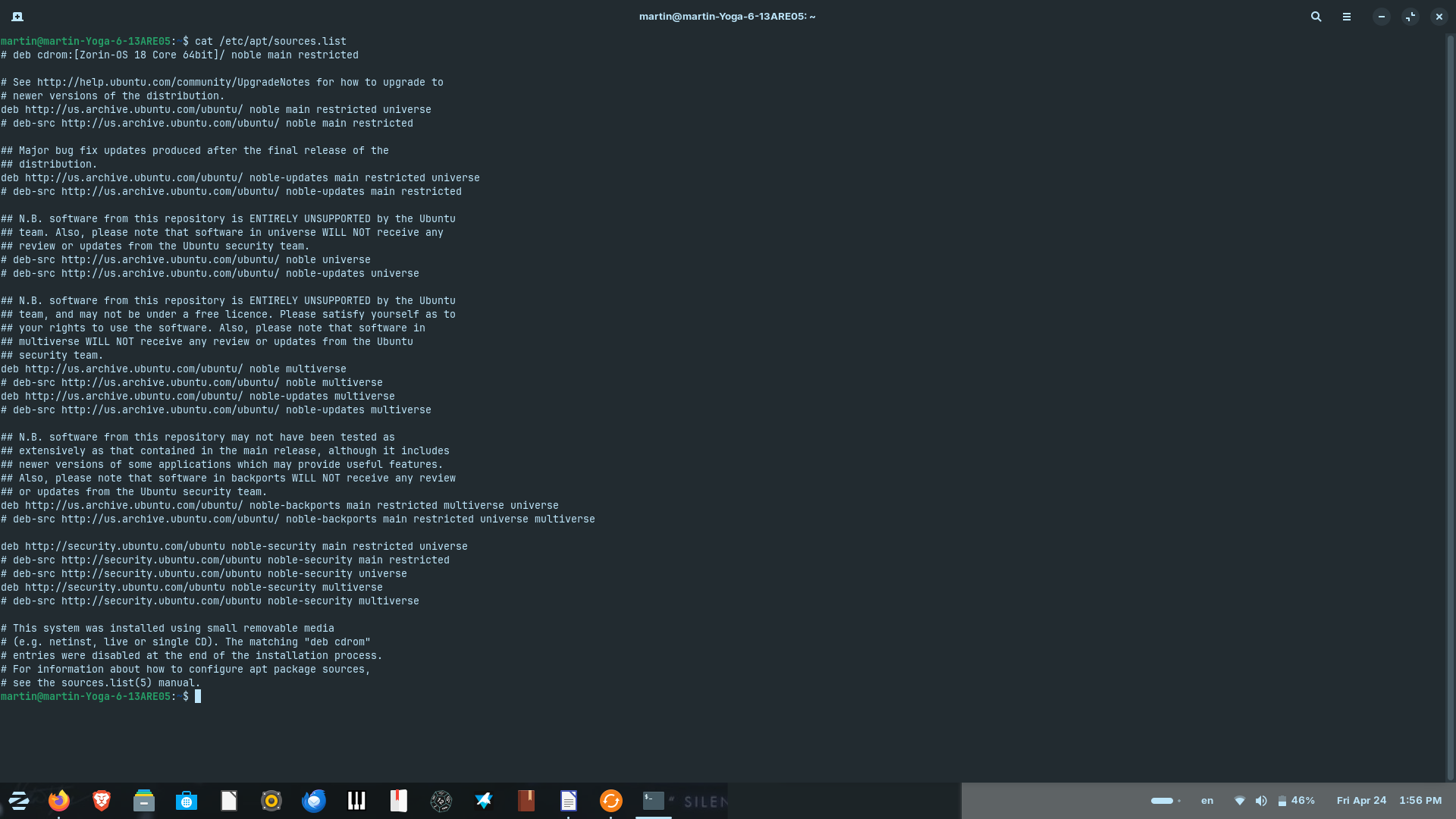

We can check for any conflicts if you relay the terminal output of
cat /etc/apt/sources.list

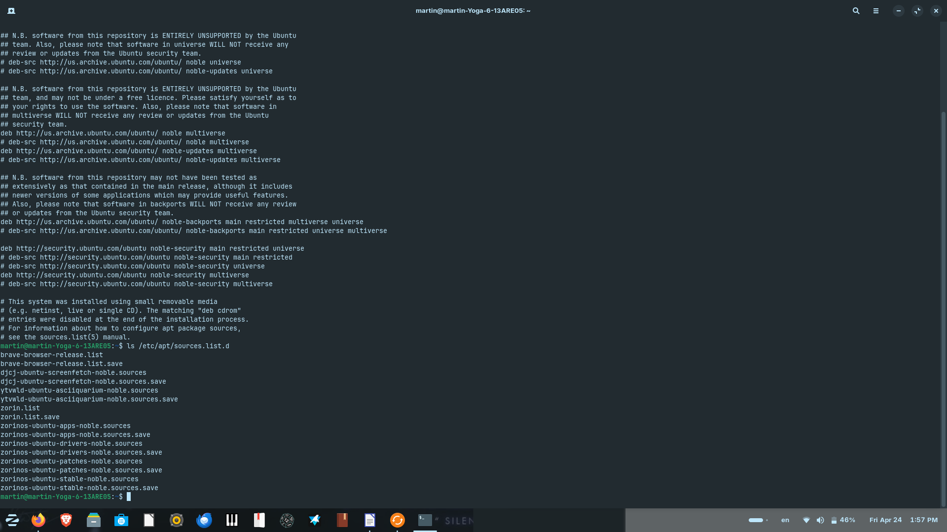

ls /etc/apt/sources.list.d

In the Meantime: It is the repository that you need to remove:
sudo add-apt-repository --remove ppa:djcj/screenfetch
The Problem is that a Repo is not working. It is the Screenfetch one. You can see it on Your sources-list.d Output on Positions 3 and 4.

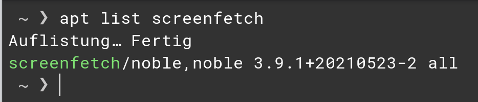

Also You don't have to add a PPA for it. Screenfetch is in the normal Repo's included:
