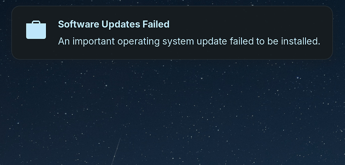

Everytime i restart my laptop for updates, i get this error on screen which says an important software update failed to install and i should contact the software providers..what could be the issue? and the second issue is on screen flickering

Is it possible that You could make a Picture of the Error Screen for the Update Issue?
This when i click view details of the error
This when i restart my device
