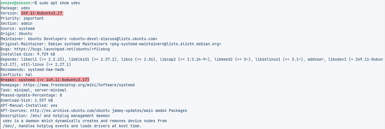

That's perfectly fine, I try to also run the updates every few days or so. Turns out, this is an update that introduces a breaking change to one of the core dependencies at is current version:
The current installed version is the one that ends with "ubuntu3.16". From the screenshot, you can see I've updated it but it shows a breaking change with systemd lower than 3.17. What this means basically is that you have to update all these packages at once.
For now, though, I'd suggest waiting a little while to see if this will resolve itself on a future update. Otherwise, you can install them manually by simply reinstalling these packages. I've done it and it works, but I haven't tested it to see if something breaks.
