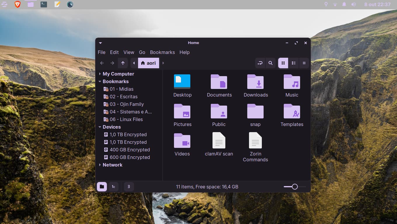

Also, @zabadabadoo, by previous kernel do you mean like any other entry from grub under the Zorin options? Well, no, but I'll try it. The screenshot is now impossible because after I shut the pc for a few hours and came back, Zorin went back to normal? It's a wild bug. But I can quickly edit an image to show you what it looks like:
Normal:
Wonky:
Like this, except when it's wonky, it gets squashed without getting wider :V just... idk it's like everything gets pulled from the sides while still fitting on the screen idk if you can get it.
