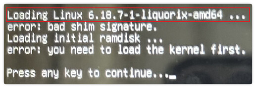

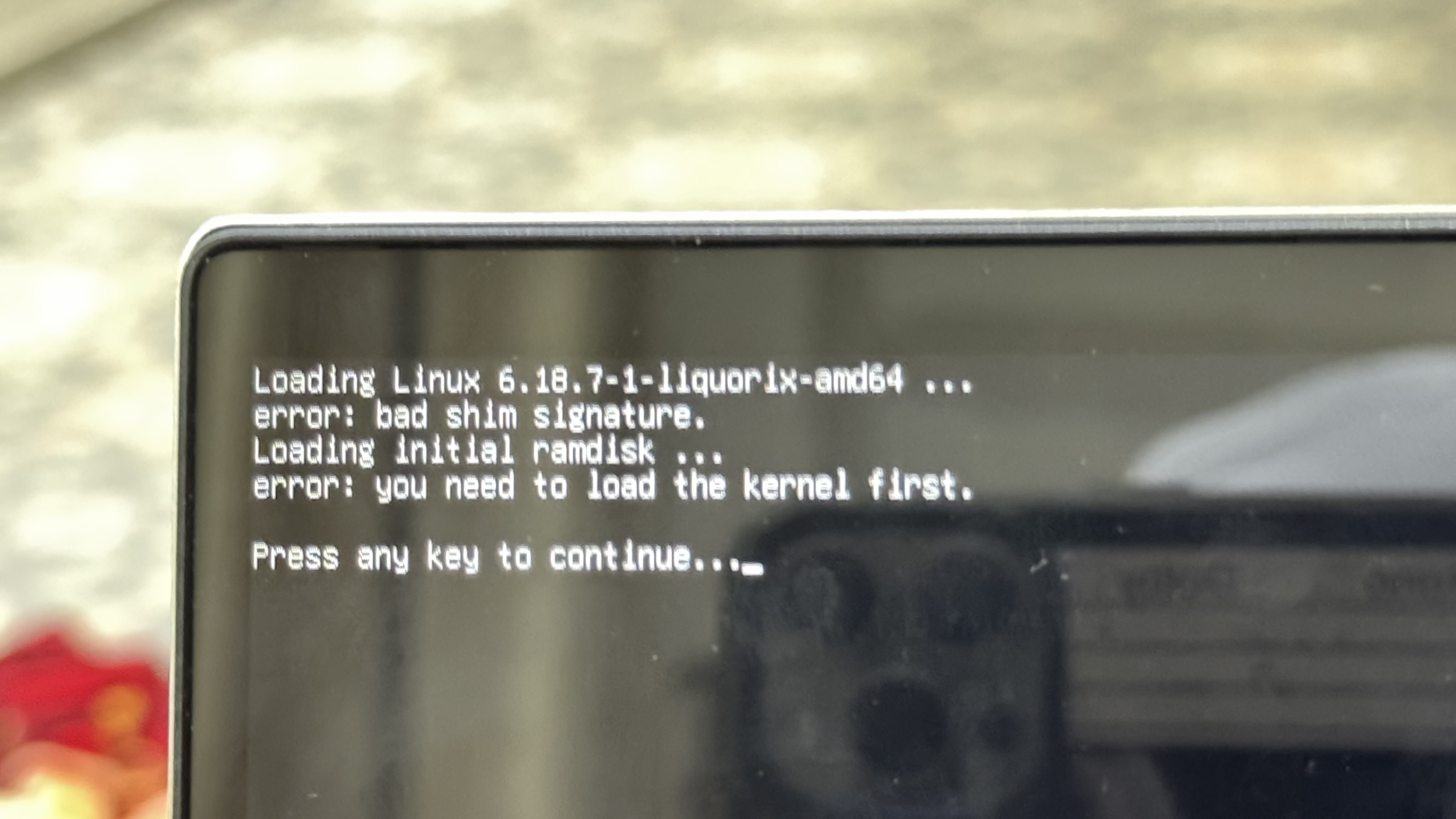

I keep facing this problem. I’ve been trying to play hytale , but I need to update my kernel to 6.15 which time I’ve been tried to do it I got sent to the boot menu and getting all sorts of errors or not able to find the package and what does find the package it just crashes. Can someone please help me
Even if I try to use any other kernel it won’t let me give me the same error well other 6.8 of course
  • Are Secure Boot and Fast Boot in BIOS disabled? If not disable them.
  • You use the Liquorix Kernel. How did You add it?
Seeing that "Bad shim signature"...
If you only need the 6.15 kernel, I would recommend not using Liqourix, actually.
You will need secure boot disabled, as Ponce pointed out - but then you can just install the 6.15 or 6.17 Mainline kernel.
The TuxInvader portion still applies for Zorin OS 17 but not Zorin OS 18
So the Mainline Installer is the way to go on 18.
I Dont Know waht is a Liquorix Kernel? i also dont know how or way i have it
That stands in Your Picture:
