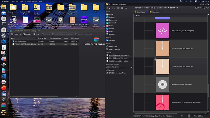

I have an Asus motherboard that uses the same utility. You download the .zip file and extract the file that becomes a .CAP file. Put this on a USB stick.
Press F2 or Del key to boot into BIOS - then go to the last tab which is something like 'Tool/s' from memory - launch the EzFlash 3 utility and point to the USB in a list of devices that gets shown and choose the .CAP file - it will tell you at the end if the update has been successful.

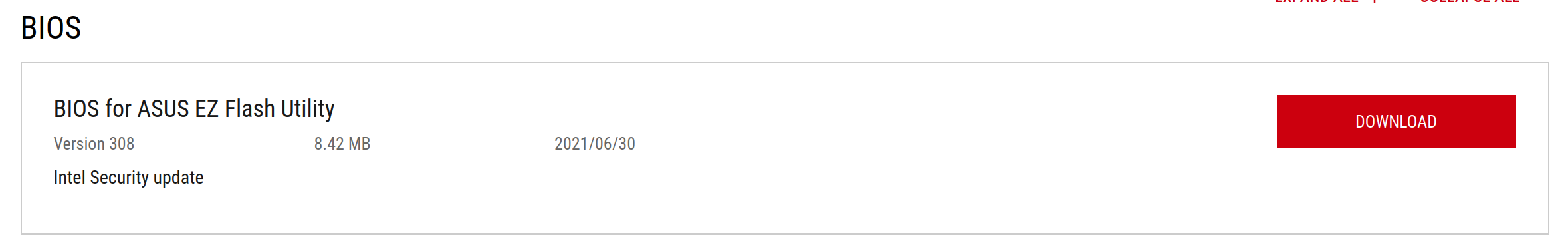

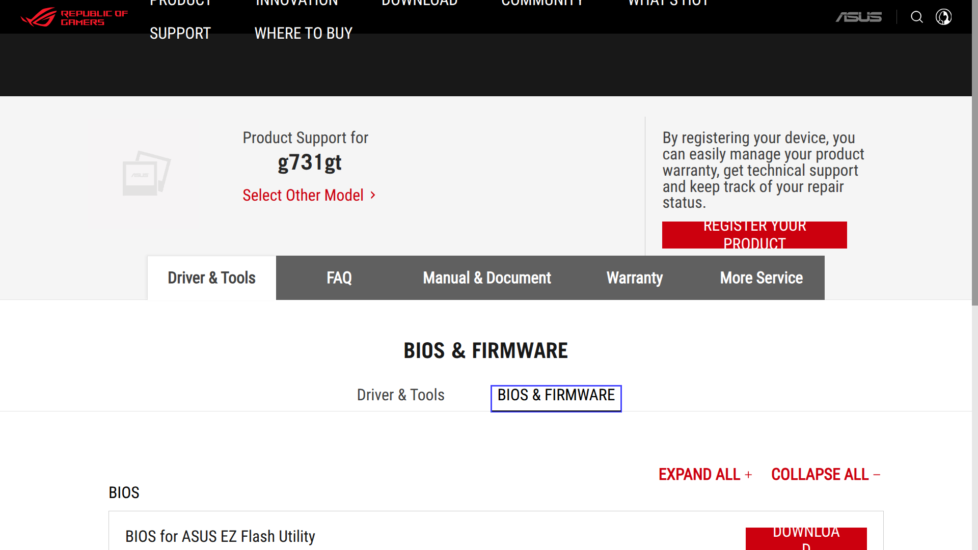

So, You downloaded it from this Website?
and choose this:
right?

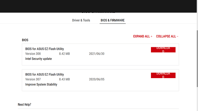

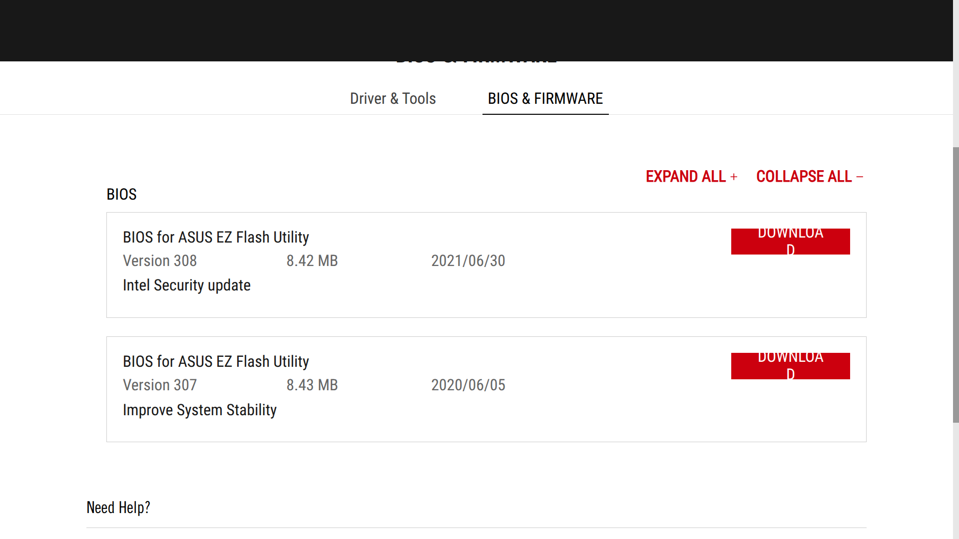

OK I found the download in a round about way on the Asus website it also gave a BIOS for Ver 307 .... do I have to download it first or just ignore it and go right to Ver 308 .... I am currently using Ver 206 ....

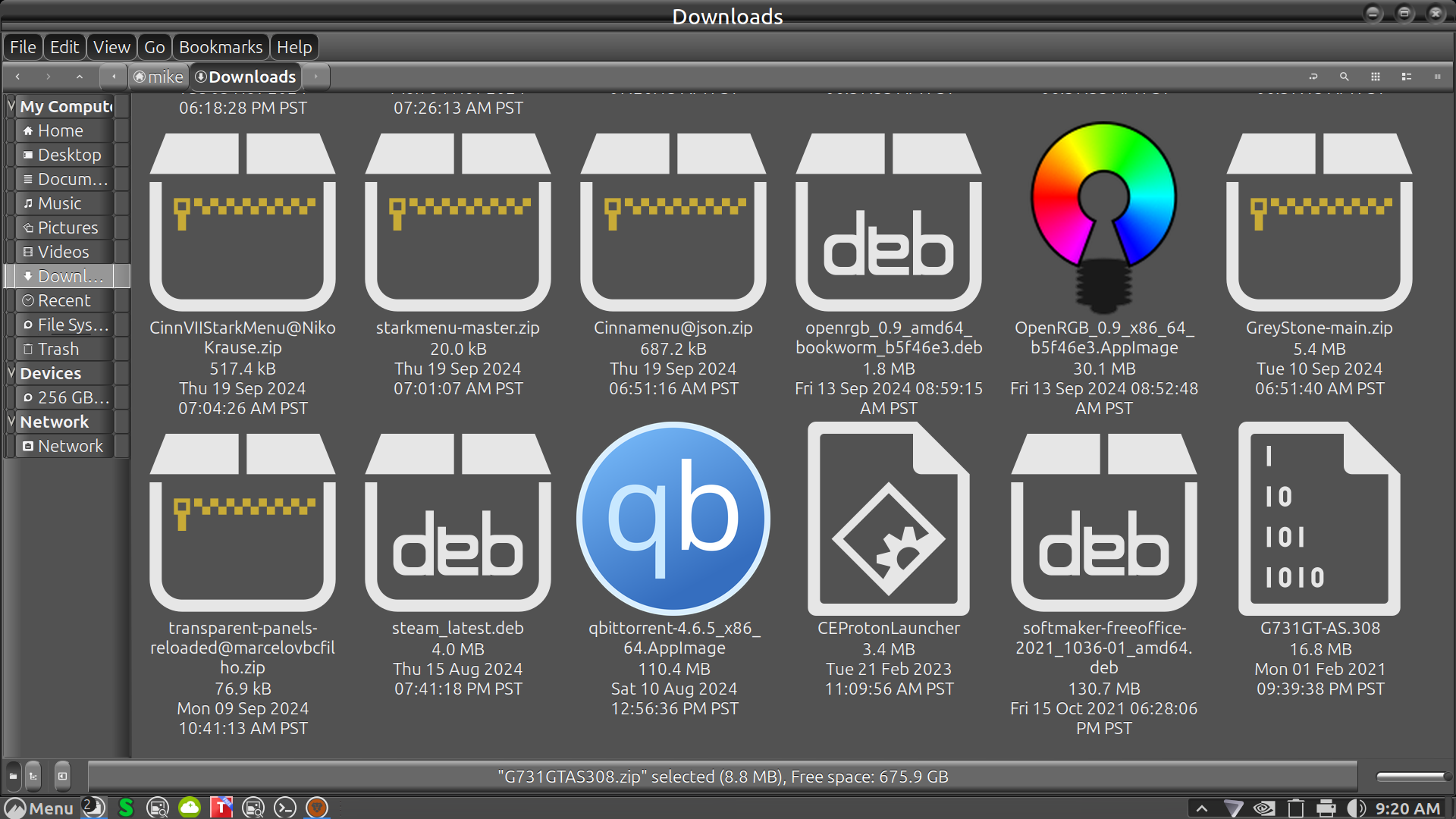

The download is a ZIP file but I suppose I can convert it to something else haven't used any ZIP files since I left Windows 3 years ago .... LOL
Just reread your reply and it told me what to do .... so the .zip file will become a .CAP file ....

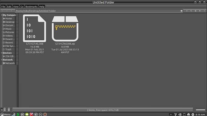

Is this what a .CAP file looks like ..... should be the last image on the bottom right .... never saw a .CAP before .... LOL
No. It ends in .CAP I will take a screenshot Photo of BIOS later. .CAP files, are specific to Asus.
You have to extract the .zip File. This is like a .tar.gz or .tar.xz File on Linux - only a different Format. And in the .zip File is Your Stuff for the BIOS Update.
I would extract the .CAP file to USB. Then boot the machine and press either F2 or DEL to enter BIOS. Go to Tool Tab and select EZ Flash 3.0 - your USB drives will show up as fs0: if the only usb present - click on it so that the contents show on the right pane, then select the CAP file and take it from there.
Problem is I can't find an apt to open or extract the zip file .... searched the web and it keeps sending me back to using the Terminal but Terminal keeps saying file not found .... UNZIP is installed as is Xarchiver (Mint) ..... but they either can't open the file or give me this ....

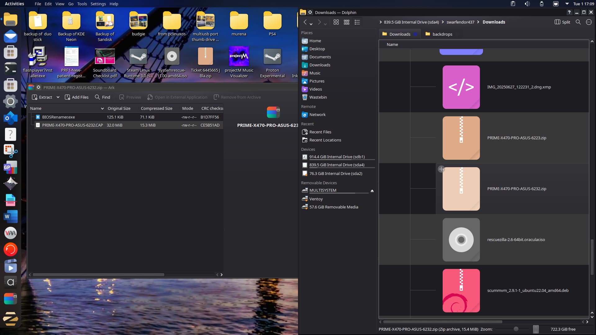

So for clarity, are you running Mint and not Zorin? Check the repos (Synaptic Package Manager) for Ark, or checkout one of the others here:
The only time I screwed a BIOS was when ASUS made a Windows installer. The only way to do it safely now is to download the zip file and copy the .CAP file to USB and navigate to it inside the BIOS under the TOOL Tab | ASUS EzFlash 3.0
