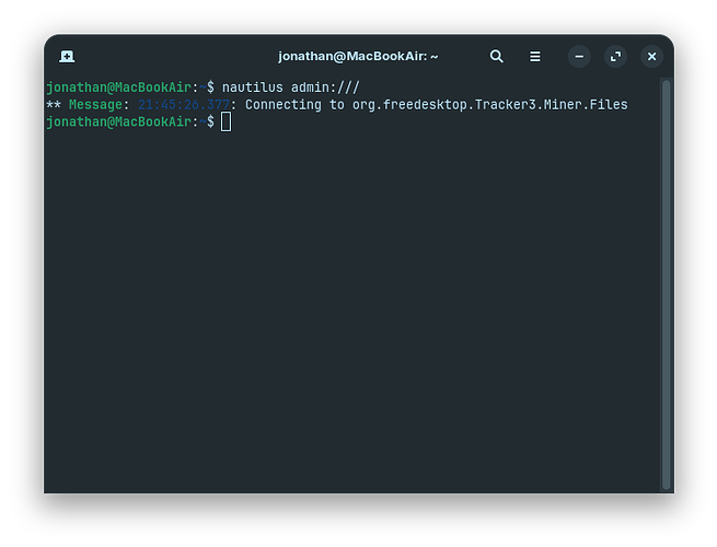

One small wrinkle, though. After the upgrade and re-running nautilus to restore the Mozilla Repo I got this message. Should I be worried?
No, that is software that Nautilus uses to pre-cache your frequently used files in order to speed up loading time.
I think the package name is tracker-miner-fs.
