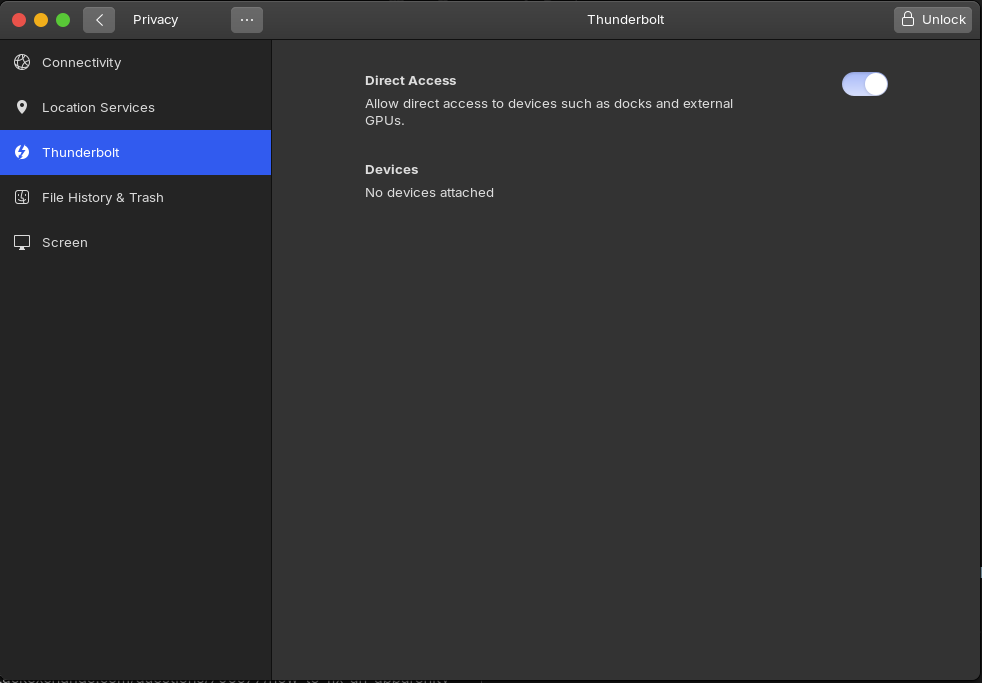

Do you have any Thunderbolt options in Settings under Privacy? I know that has something with GPU but not sure about other external devices.
The version was already up-to-date and there is no Thunderbolt in the settings.
