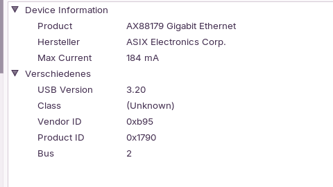

I was able to read this from the system
grafik
So, we are specifying the correct driver...
It should be included in the kernel.
