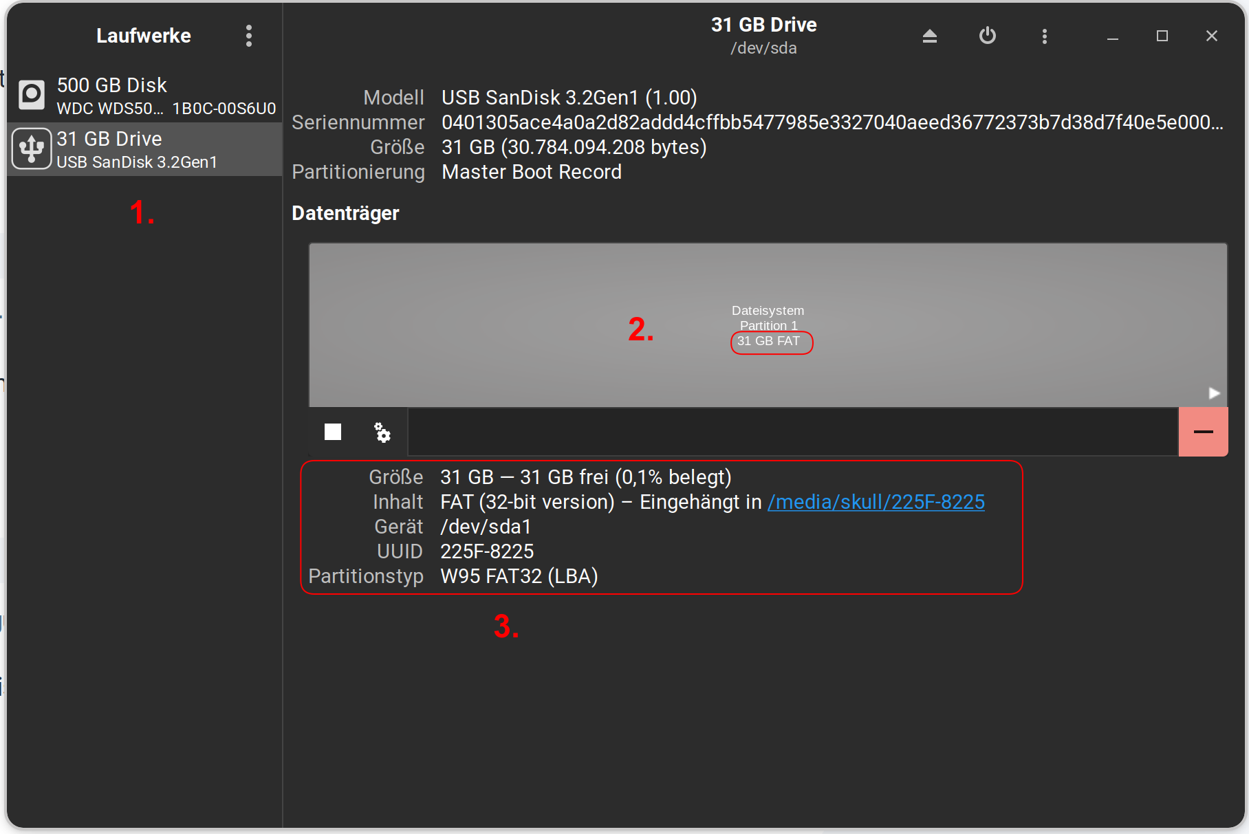

Okay, open Disks (don't Care about the visual Style, that is my Theme) and then 1. click on Your USB Device and then look to 2. and/or 3. for the Format of the Device. If You should be unsure, post a Picture like I did.

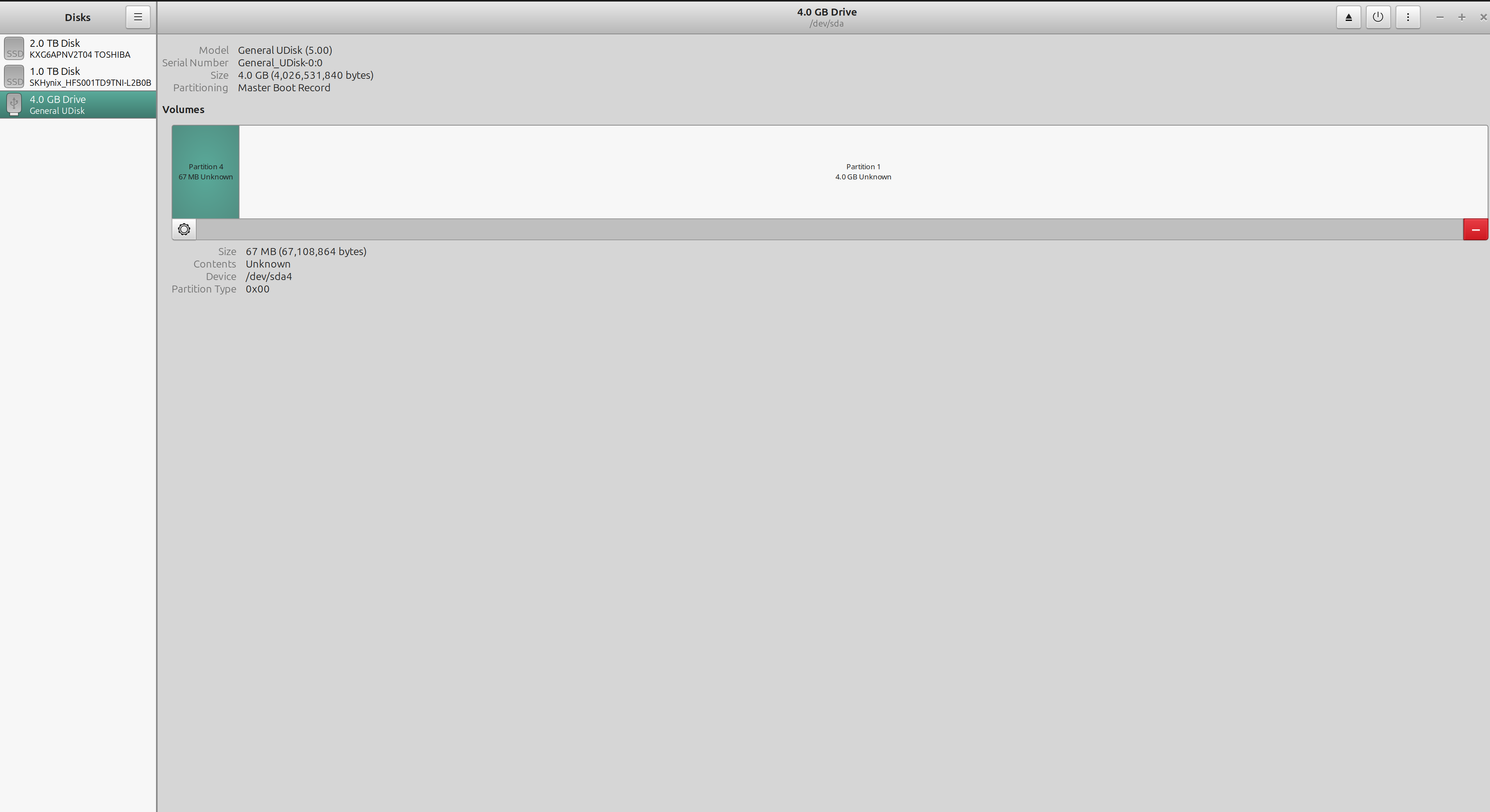

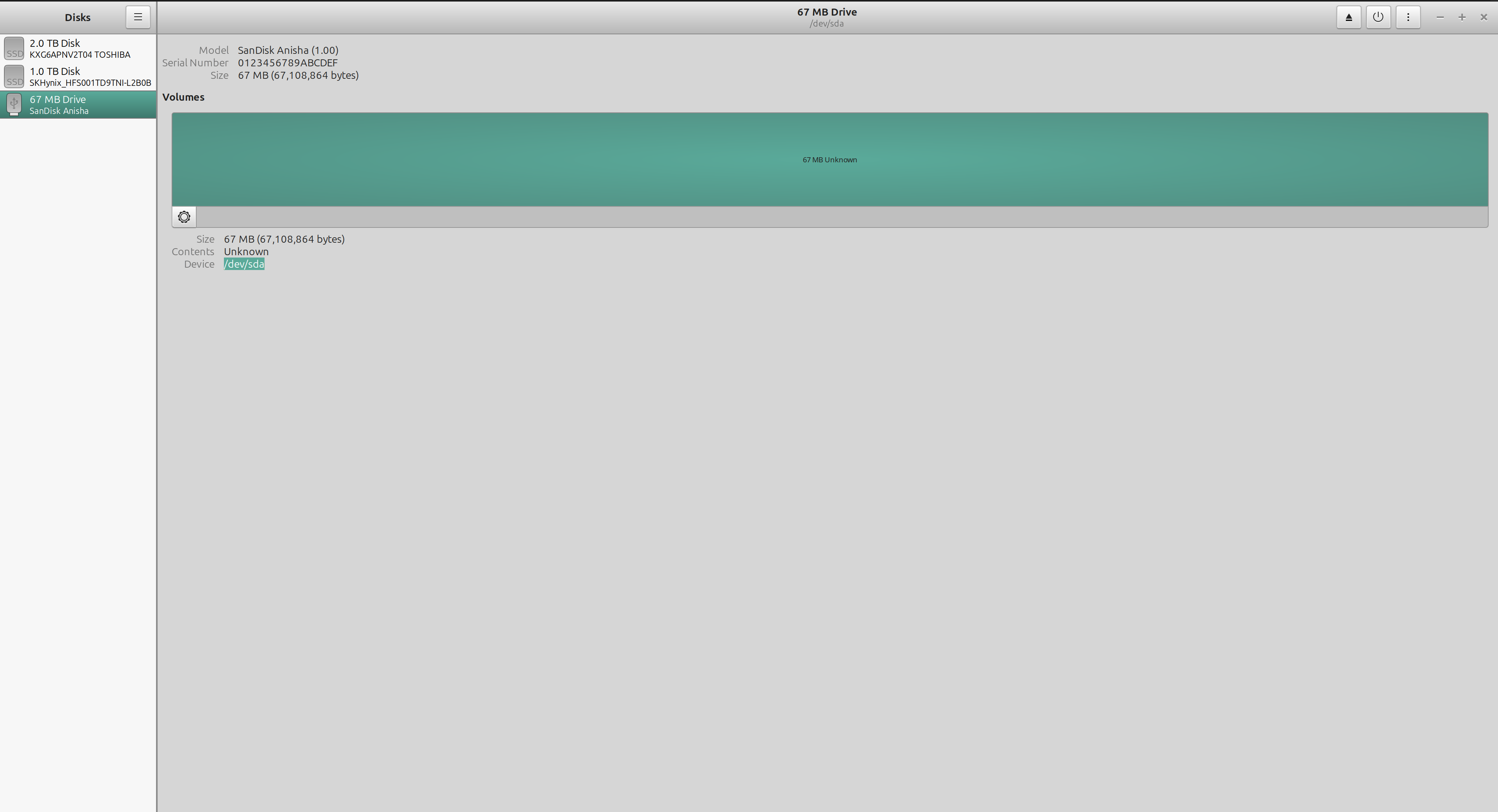

Hmm ... that looks weird. The Serial Number looks more like a Placeholder and it only detects 67MB ...
For what have You used the Stick before? And what Data are on it? Did You used it for creating a Boot Stick? Do all Your USB Sticks look like this?

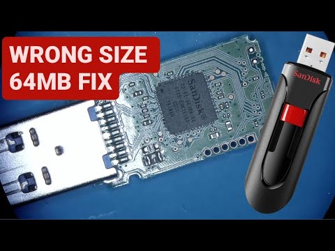

This situation is so strange, that I decided to do a search with your flash drive name, and available storage quantity.
That post explains what has happened to your flash drive, a video from the post as well here.
You could try to employ a fix in the video. If you asked me however, easier to just replace the flash drive IMO.
And these are not brandnew Sticks, yes? And on all theses Sticks are Data? What kind of Data are on it? Documents, Pictures, Music, Vidoes etc.? At least on the last one are the 4GB detected - even when there are 2 Partitions on.
