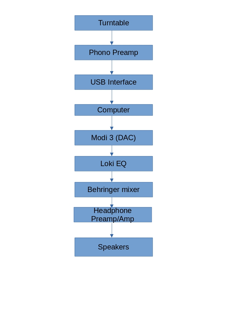

I have trouble understanding your setup, too. A lot of things can go wrong here depending on how you connected everything. Would you mind drawing us a little diagram? It would be very helpful to understand the signal path.
For example, how come you have two DACs connected at once? USB interface and the Schiit Modi? That wouldn't really work.
And then, how is your turntable connected?
Maybe we can be able to help once we understand your setup a bit better.
Like I've said before all this works fine in Windows with no issues. My turntable is connected to my phono preamp, then to my USB interface to my computer. My Schiit Modi is connected to my computer via USB. It's connected to my Schiit Loki equalizer, looped through my Behringer mixer then to my Starving Student tube headphone preamp/amp for clipping control. My powered Klipsch speakers are connected to my Starving Student tube headphone preamp/amp. It may sound confusing for someone who may not be stereo minded, but this is how I listen to my music on my computer. Everything works fine except that I get no sound from my setup when playing an album from my turntable. It shows playing as it records into Audacity just fine, but no sound through my speakers. Nothing is muted in the Sound settings. Nothing shows from the VUE meter when looking at the Schiit Modi 3 while playing an album. I was having this issue when I was trying out Linux Mint and I couldn't figure it out either. My goal is to eventually move over to Linux from Windows since it may move to a subscription only OS when Win 12 comes out (nothing official from MS yet, but there are many indicators showing it may lead to that). I can play music on FooBar2000 and videos on YouTube with no issues. It's only when I play an album from my turntable. I'm hoping I won't have to upgrade to the newer Scarlett 2i2 4th Gen. I can hear my album playing on the headphone jack on my interfaces, but that doesn't work for listening to my speakers.
Here's how my setup is connected. I hope this helps.
