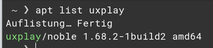

When I see this:
it doesn't seem to come from the Repo because there is Version 1.68 available:
