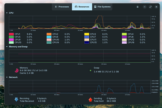

First of all the hardware Zorin is running on:
Lenovo V15 Laptop 15.6"
AMD Ryzen 7 7730U
16GB RAM
1TB PCIe SSD
HDMI Type-C
Zorin is the only OS installed on the computer, no dual boot and I used the default guided install method of the installer. I chose to set it up with LVM and LUKS encryption. I don't have much intalled on it besides what it came with; Steam and Lutris but have not installed any games yet. The other thing I added were language packs and a bunch of extensions on firefox.
The issue is that when I have nothing open the computer uses way too much RAM but I have no clue why. Is the sistem monitor wrong or is Zorin actually using this much? It wouldn't be difficult for me to reinstall it because I have everything backed up and I don't have to worry about boot issues with windows.
Any help would be much appreciated.
It would be helpful if you showed us the Processes tab and what it says there, while sorting the RAM usage from highest to lowest, so that processes that take up the most RAM are shown on the very top.

It's a gnome thing i guess. Nothing special installed only steam and some games.

If I have booted my system, by default I think my system uses about 1.5gb, and I've got 32gb installed. using 66% of their 16gb seems a good bit high if nothing is being used.
Its technically normal with gnome. Just running the OS, its not unheard of to use 5.4GB of RAM on gnome. If you have a browser window or 2 open, its not uncommon to see an additional 1GB to 3GB added to that.
Also, if you never shutoff your computer or restart it, its not uncommon to see the RAM usage, go up even higher still, as all sorts of media gets cashed into RAM.
The more RAM you have, the more RAM gets used. I have 32GB of RAM, and I've seen my RAM usage go up to 21GB to 28GB a couple of times, although usually hangs out around 15GB or less.
This is the reason why some people, those who work in heavy production, require 64GB to 128GB of RAM. Most of the time however, 32GB of RAM suits me just fine.
And lets be honest, 16GB of RAM that you have, is usually considered more then enough for light gaming, light photo editing, light video editing, and general computer usage.
