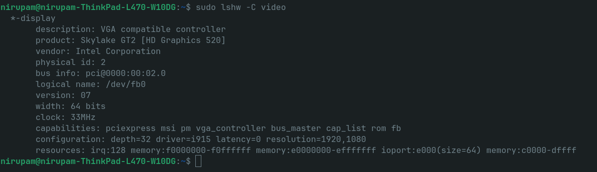

Let's start at the beginning. Running Zorin in Try Zorin mode, please post back the results from a terminal command:
sudo lshw -C video

I'm able to start succesfully. this is the output in installed zorin.

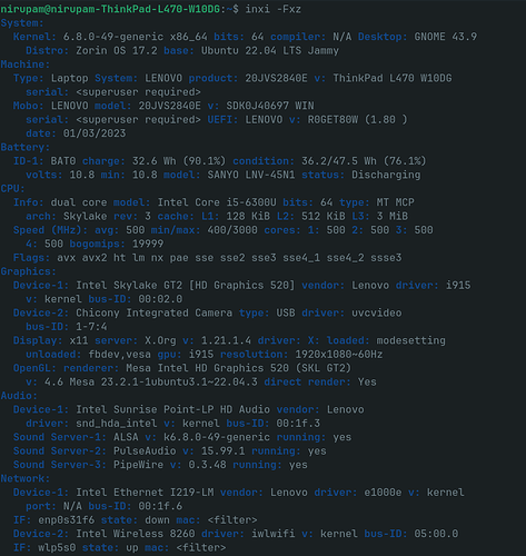

my system info

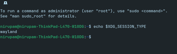

@silentsurfur are you using Wayland or X11?
