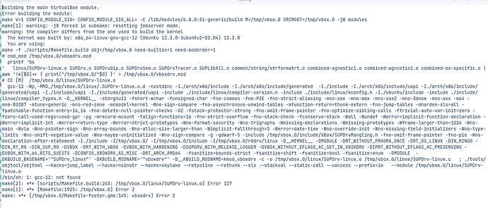

Just upgraded last month form 16.3 to 17.2 - I installed the latest version of VB from Oracle and tried to set it up for a Windows VM. I got an error message (see image).
I tried the command suggested in the message in Terminal [sudo /sbin/vboxconfig] and this was the result:

Maybe it is a secure boot issue like @reahcsa suggests. I just installed VirtualBox 7.1.4 on Zorin OS 17.2 like 3 days ago from the Oracle site for a project I'm in the middle of. The VirtualBox in Software (6.1.5) threw an error about building, something about needing at least VB 7 for my kernel. Or something. I didn't really pay attention I just started searching the web for version 7+. One of the machines I created was a Win10 and it didn't throw that error. I don't have secure boot on host or guest.

The error message it's referring to gcc-12 but Zorin OS doesn't have that by default. Please see this thread for reference:
I thought about that but I had checked and the gcc is 11.4.8 on my Zorin OS 17.2. The download I chose from the Oracle site was Ubuntu 22.04 version. So I don't know what the difference it, except I never updated this machine from 16.3.
Correct, gcc is installed by default, but at version 11, whereas version 12 is needed in this case. Why there are two different packages for each version, I don't know...
