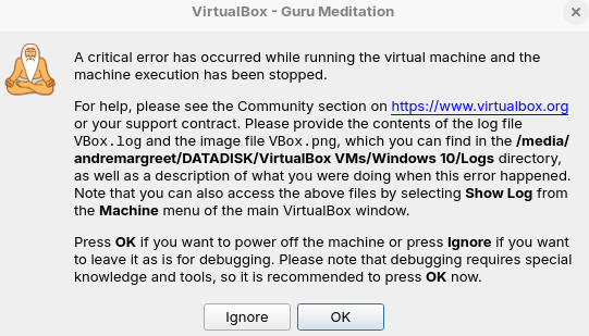

But after starting VB some days ago, VB reported a fatal error.

Do You get a specific Error Message? If yes, could You post it here please?

I will check the specific errormessage.

Vbox logfile:
Vbox.log
