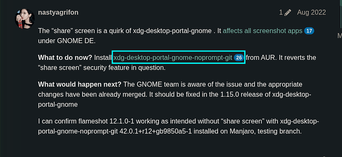

Second issue relates to third-party screenshot tools. I installed Flameshot and set its shortcut to PrtSc key, but no matter how I opened it, a screenshot was taken by some Gnome's built-in tool, and then it asked me whether I wanted to share that screenshot with Flameshot. It's some kind of portal issue, read here:
According to this forum post, the issue was fixed long ago, but still presents a problem in Zorin. I already have the latest version of the highlighted package:
For now I have switched to X11, enabled both animations and jelly mode to get rid of the visual glitch, AND to get rid of the screenshot portal issue that does not persist when using X11. Now when I click PrtSc I immediately get Flameshot working instead of having to 'share' screenshots to it.

Yes I understand this is up to gnome, but I thought that maybe since the issue has already been fixed (years ago it seems) that Zorin is lagging a bit behind and missing that fix. I have no idea if that's the case, which is why I voiced this issue.
As for the second problem, that should be a Zorin thing, and it's good to let devs know these extensions are sometimes having unexpected behaviors. This goes together with the bug of windows minimizing to the top left corner instead of their space on taskbar, but I think I already posted about this bug before...
