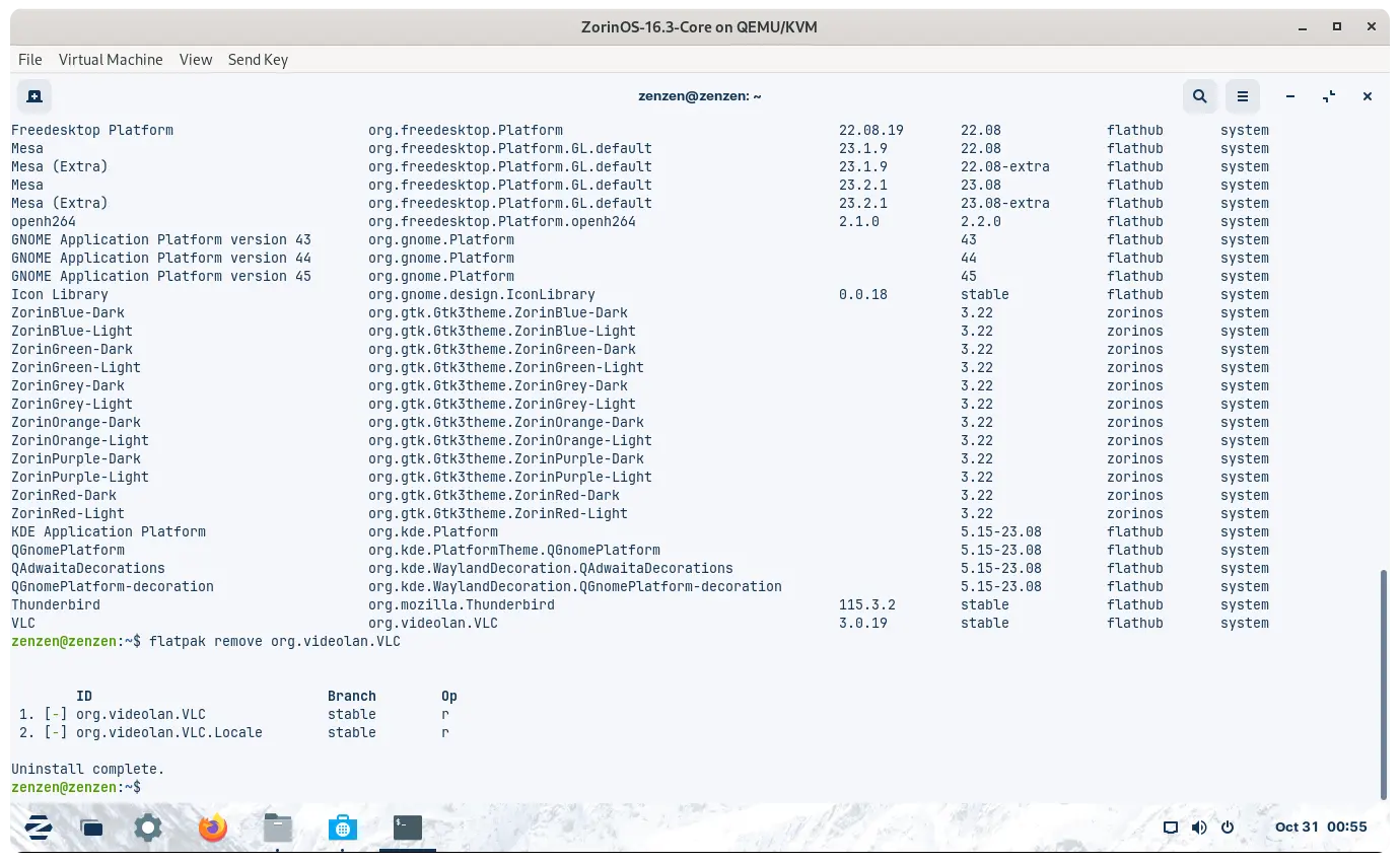

Did you install VLC from the Software Store? If so, you have a dropdown menu to choose the source of the installation where you have the option to choose between Flathub and ZorinOS. Make sure you use the ZorinOS one.
If you are not sure, open a terminal window (search for "terminal" in the applications) and run the following:
flatpak list
If you see VLC listed in there, remove it:
flatpak remove org.videolan.VLC
Than, you can proceed to re-install but choosing the ZorinOS format instead. Hopefully this will do the trick.

Yeah... it's complicated. There are pros and cons to both options but long story short: I'd recommend to install the .deb package format whenever possible (this is what appears as "ZorinOS" in the Software Store), as it's the native format for Debian-based distributions. If that's not an option then use Flatpak.
