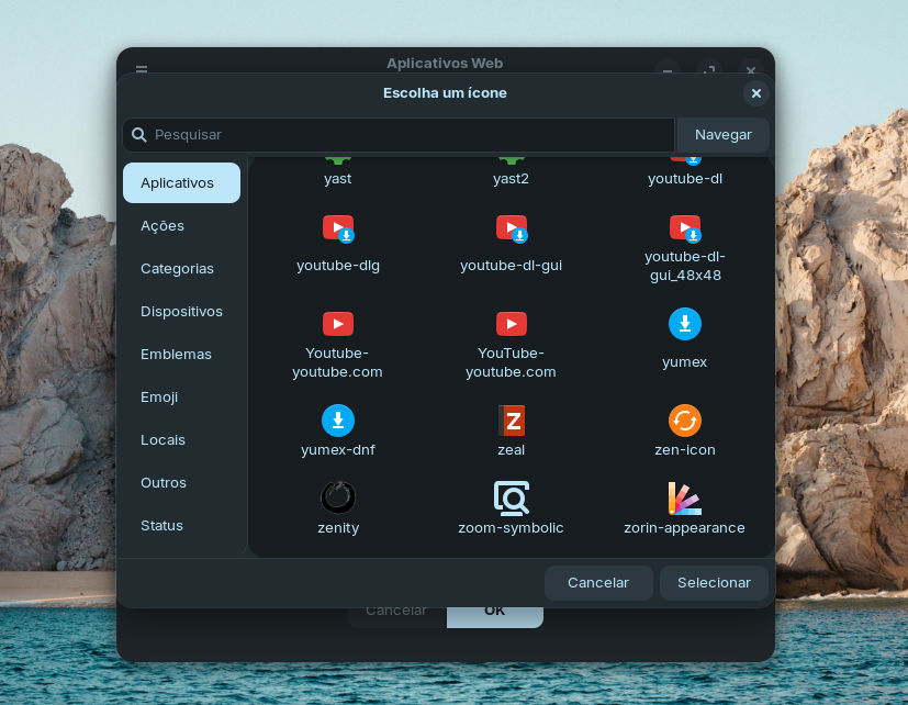

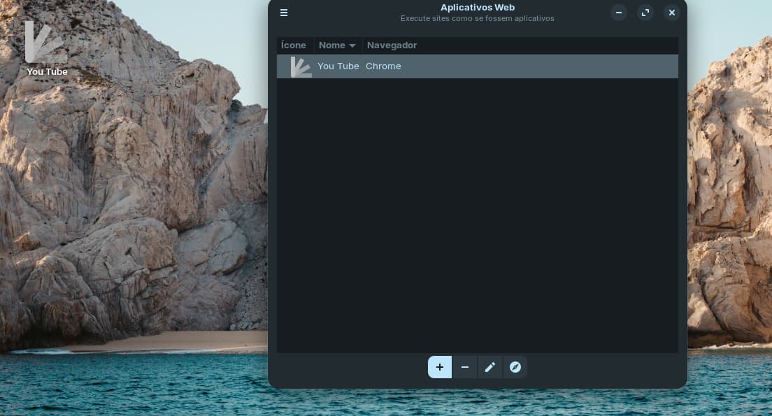

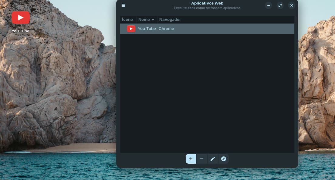

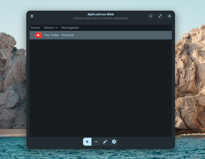

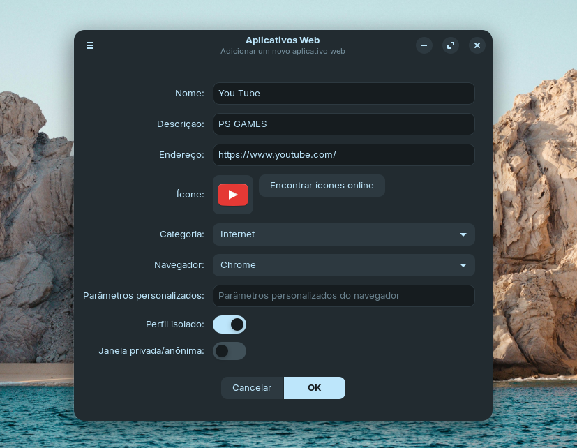

Hello and good afternoon to everyone in the Community.
I read this thread and went to test the Webapp application. As you can see in the images, I tried the icon editing section, and everything worked fine for me! Before finishing with the "OK" button, clicking on the icon chosen by the app (online) opens an icon tray with hundreds of options! It even has a search box to find the one you're interested in. I replaced the YouTube icon with the Zorin Appearance one as a test, and everything is fine. The only drawback was having to manually delete and pin the new icon to the desktop. Another thing that won me over was the isolated profile feature! I thought it was fantastic!

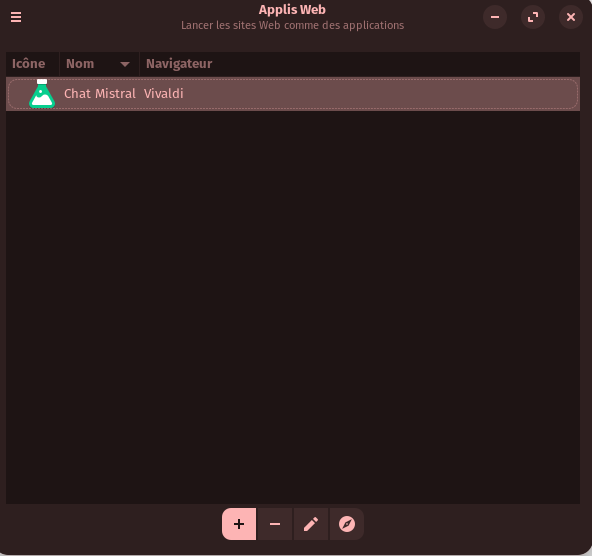

No, actually, I've installed Webapps using Web Application tool from Zorin 18. Funny is that after fixing the icon problem, the applications disappear from the list in WebApp tool.
So, for example, I'm installing Mistral AI Chat as WebApp using Zorin Tool :
I installed it, it appeared in the list:
And again I got the problem with default gear icon instead of wanted icon for this app:
I followed the procedure suggested by @Forpli, fixed the icon:
And, voilà, I have WebApp working fine, with correct icon, but the list of the webapps in the WebApp tool is again empty.
This seems to be a bug in WebApp tool of Zorin, but it is fixable, so, no big deal.

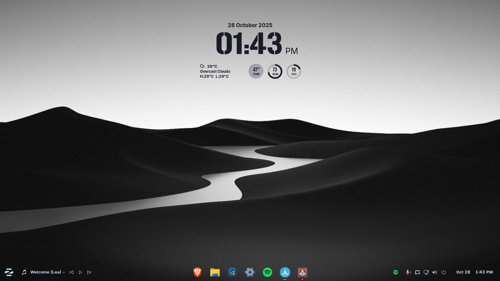

Hey! I use those web apps too and ran into the same issue.
Turns out, it’s basically a wayland quirk. The easiest fix is to run Zorin on Xorg, since some of Wayland’s security features make this kind of thing a bit tricky.
Alternatively, when creating a custom web app, you can add this launch parameter to force Xorg mode:
--ozone-platform=x11
That should get your icons showing up properly.
Small bugs...but at least we have workarounds! :grinning_face_with_smiling_eyes:
The 2 other apps after spotify are web apps showing correct icons.

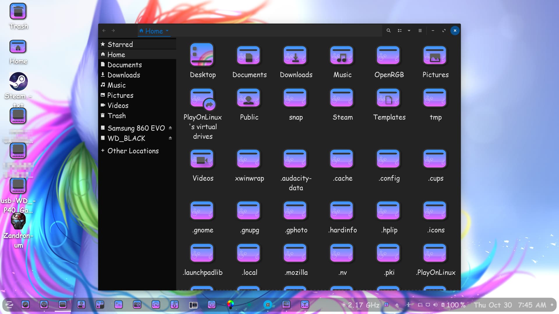

Hi, welcome to the forums!
First, thanks for sharing that tip; I'll keep it mind for future reference!
Secondly... do you mind sharing what icon set are you using? :eyes: (cool desktop by the way)
You're welcome! I'm glad you found the tip helpful. As for the icon set, I'm using the Win 11 icon theme. They work very well with zorin.
P.S. Thanks for the compliment on the desktop! I really love customizing stuffs !! :grinning_face_with_smiling_eyes:
