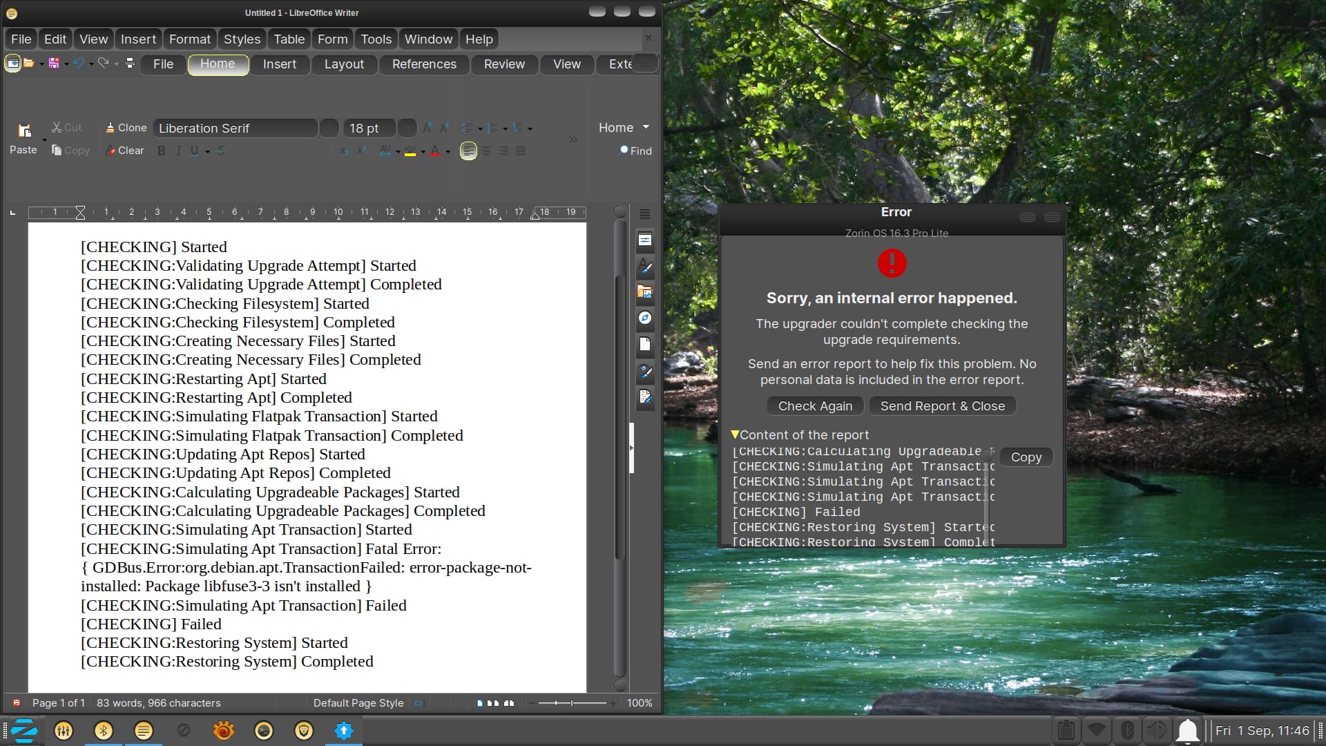

Well Houston we have a failure .... no lift off ....
Everything went fine until we got to Upgrader Check Your System and this came up ..... I clicked send report and close .....
So I typed .... sudo apt install libfuse3-3 ..... into the terminal and it got installed ..... I tried to install Lite Pro again and this time got this error .....

[CHECKING:Simulating Apt Transaction] Fatal Error: { GDBus.Error:org.debian.apt.TransactionFailed: error-package-not-installed: Package fuse3 isn't installed }
[CHECKING:Simulating Apt Transaction] Failed

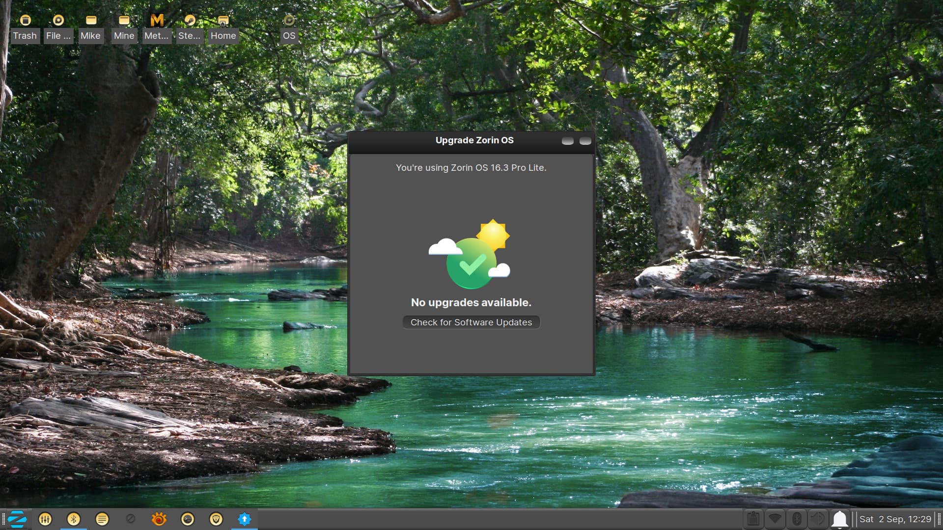

OMG ..... if this ain't something more on this tomorrow
BUT IT SAYS ZORIN PRO LITE IS INSTALLED
Finally I will never forget the command .... sudo apt install .....
Bye to tomorrow ..... :weary: :confused: :confounded: :sob:
A great big thanks to everyone that participated in this endeavor .... it appears we were successful .....
