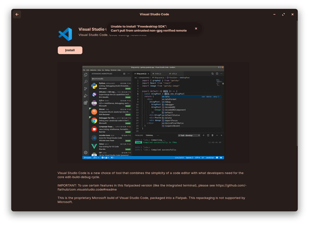

I put this code in the terminal, but the problem exists.
sudo apt install gdebi
I put this command, but it says that there is an error.
flatpak install com.visualstudio.code

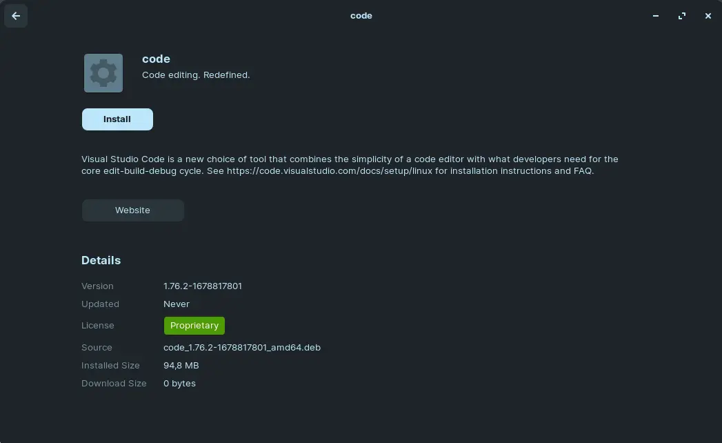

I downloaded the program from the official page, and when I open it, it takes me to the system store and tells me to download the program from here. When I click on Install, it tells me this message that I saw
For flatpak option: run flatpak update first, and then try to install again.
For the deb option, did it offer you the option to install from the software store? If so, it will actually redirect to the flatpak option which is the only one it can find over there. Try to click on "Run anyway" to make use of the .deb package you downloaded.

Fixed it.
The answer is at the bottom of that screenshot - the system did not like the untrusted signature of the package you were trying to install!
How can you fix this untrusted signature? I can install it just fine ![]()
The short of it is- this is a common Flatpak error.
A person might have some luck running:
sudo flatpak repair
flatpak update
But many users report that also does not work - This is because the only way the above can work is if they are running something in Flatpak that has since been patched / repaired.
The quick and easy fix: Do not use Flatpak.
